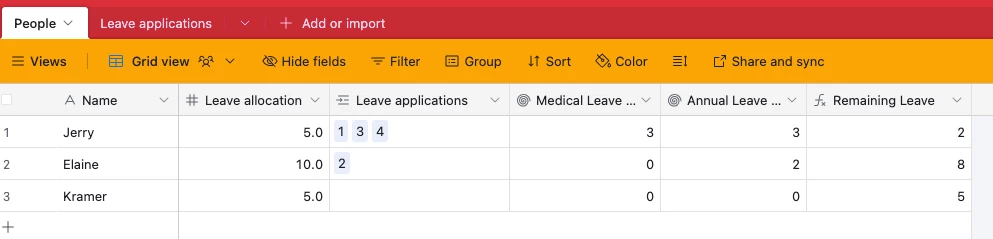

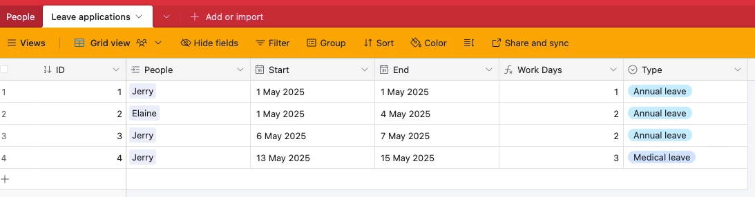

Hmm the trickiest bit when I’m building these is dealing with yearly leave allocations
If you’re just starting out I reckon just make one base per year and then duplicate it for next year so that all your automations stick around as that’s a lot easier to set up
I’ve put something together here for you to check out that has the basics of it set up to get you started:
If you could talk about specific issues you’re facing in set up that’d be helpful too

Just to answer a few of these questions…
  • There are always a bunch of ways to structure templates, what Adam provided above is the cleanest/simplest version. Look at what he provided and ask yourself what other data needs to be included, and whether that can/should be included on the tables provided. If not, then more tables are needed.
  • This would depend on your level of reporting needed, plus how many leave options you provide.
    • One thing not included in Adam’s basic version here is approval status (Submitted, Approved, Denied). You might need a separate Fillout for approvals v requests.
  • Record ID are automatically created for every record, they’re just in the background unless you create a formula field to display them. You can make a formula field with RECORD_ID() that’ll show the ID, but even without that they’re still usable in automations.
  • For manager notifications, you either need to make the People field self linking or create another table for Managers. Then you can add email addresses to the relevant table and create an automation that sends an email to the direct supervisor.
All of this is doable on the free plan, but there are some notably limitations, specifically you can only have 1000 total records in the base (so that’s all leave requests, people, managers, etc) and you only have 100 automations a month (so those manager notification emails for instance).
One other consideration I’d make is in Adam’s setup, he’s allocating leave by whole days. You might want to include more granularity and allocate by hours instead so people can take a half day, couple hours for a Drs appointment, that kind of thing.
