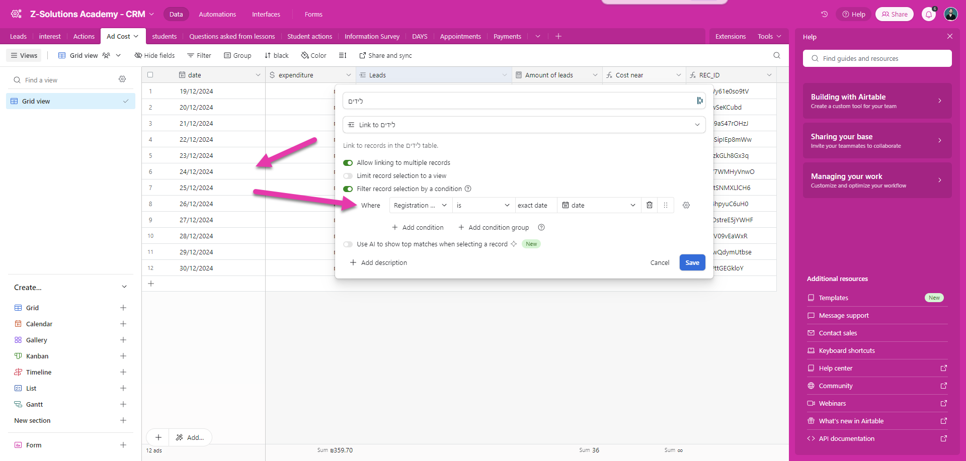

I have one table of leads
Another table of Ad cost
I want the Ad cost table to sum the number of leads I have on the same date from the leads table and then actually make a formula that will divide the advertising cost by the total leads.
I made a Linked record for the leads table and made a filter that will show me only the leads whose "registration date" is the same as the date that appears in the date column.
It does show me all of these leads (except for the ones whose date is the day after for some reason) but I don't understand how I can just automatically pull them into my list without using any automation that would make everything complicated!

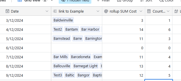

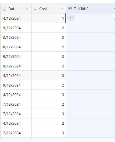

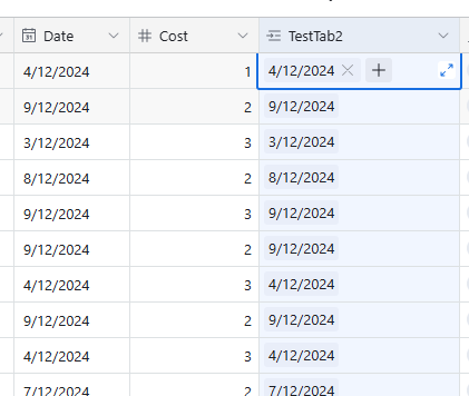

You have to set links between records in 2 tables. In your case, it seems like you need to copy dates field in Leads table into Linked field. Just copy-paste the whole field
Ensure Dates in the same format in both tables.
Then in Ad cost table, add rollup SUM (values) to add any Numbers from Leads table, or just Count to get a number of linked Leads.
