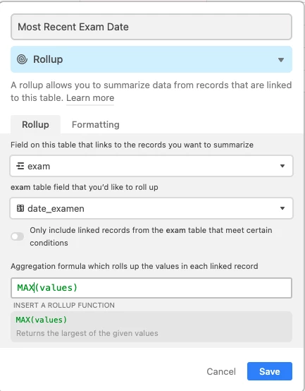

If you are looking to pull the date for the most recent exam date for a classroom with many exams(I added two exams to the same classroom):
You can do so using a rollup field and the MAX() formula to find the maximum date (or most recent) date of the Exams for that classroom:
Now looking at that table you can see the most exam date is the one listed in the “Most Recent Exam Date” field:
