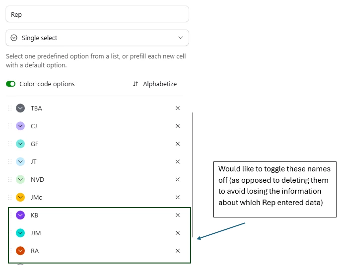

I have a decent sized based we’re using as a CRM. Every entry is tagged with a representative’s name in a single select field. Over time, some reps have come and gone, and I don’t want to have their names available to select for new enteries, but I don’t want to lose the data of who made previous entries. What I really wish I could do is toggle certain single select options on and off, but I don’t believe I can do that without losing the formatting that we have now, which is helpful. Anyone know a way around this? Screen shot below of what I’m trying to achieve. I do not want to use an interface to resolve this problem, as my team typically does not use interfaces that are built for them! Thanks for any advice you all might have!

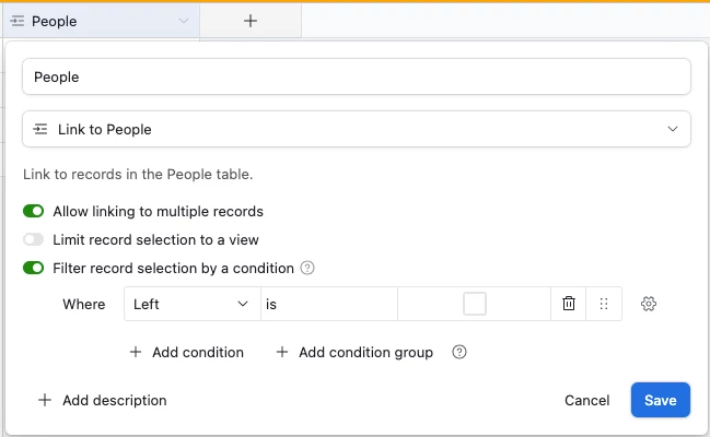

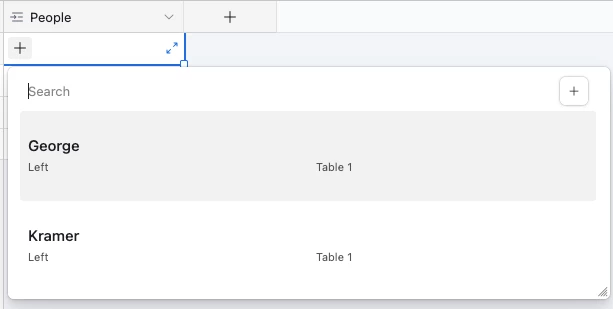

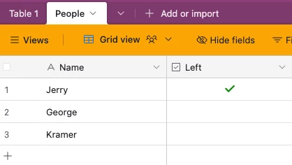

We can’t do that with single select fields I’m afraid.  As a workaround, you can use a linked field with a filtered conditional for this and I’ve set it up here for you as a reference:
Data:
Filter setup:
Options during selection:
