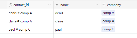

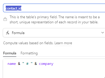

One way to ease the process is to set the contact table primary key field as a formula to concatenate contact name and company name, for example:

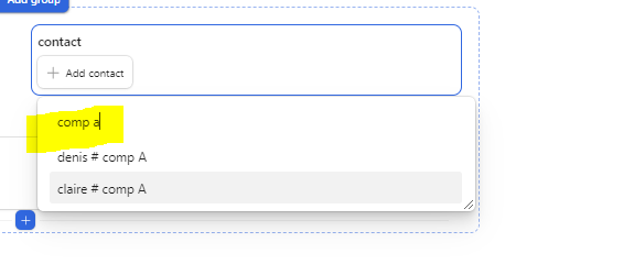

Then, when calling the field "contact_id" in a form, you have the possibility to search on the company name and hence reduce the list of possible contacts to this company:
