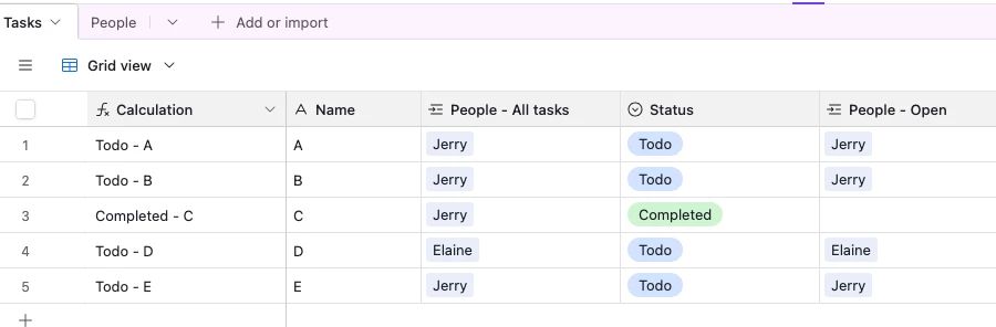

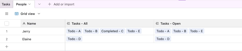

Oooh, thanks for this! I’m one step closer but still not fully there. In the Team Members table I already had the Tasks linked field, so now I have created a lookup field in the Team Members table that pulls from Tasks, and set the conditions based on task status. So far when I do that I can pull in the content of a particular field from Tasks (like Task Name or Status) that have the conditions specified, but I can’t pull in a link to the actual task itself. Is there a way to use that lookup field to show on a view of a team member record only the tasks that are open in a way that then allows us to click through to the task view?
Hmm I think you’d need to create another linked field for that I’m afraid, and you’d use automations to keep them up to date.  Specifically, when a Task was marked as ‘Complete’, you’d get the automation to clear the ‘People - Open’ link
I’d also have another automation that would trigger whenever a Person is linked to a Task that would paste the same Person into the ‘People - Open’ field

That did it! I set up a completion automation that removes the assigned team member, adds the user to a completed-by field, and adds a date completed. I super appreciate everyone’s help!
