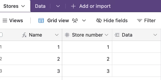

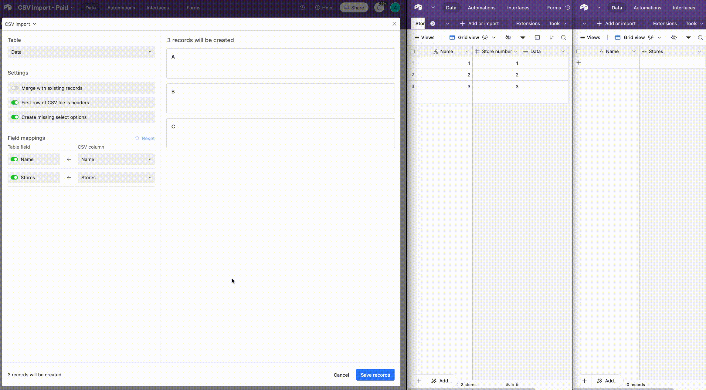

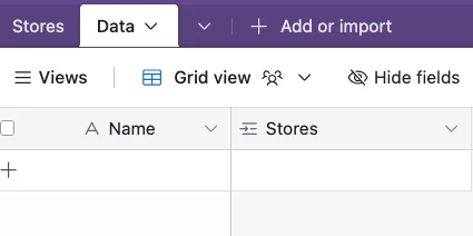

Hmm, I tried the setup you mentioned of making the primary field be the Store number and it seemed to work fine, and so I think my test is structured differently from your data (or I'm misunderstanding what we're trying to do, sorry!).  Any chance you could provide some screenshots of your structure?
Here's what I tried:
CSV:
Name,Stores A,1 B,2 C,1
And when importing the CSV it created 3 new records in 'Data', linked to the Store records appropriately
CSV:

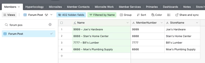

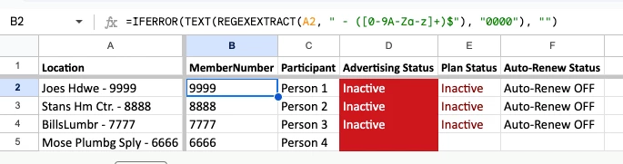

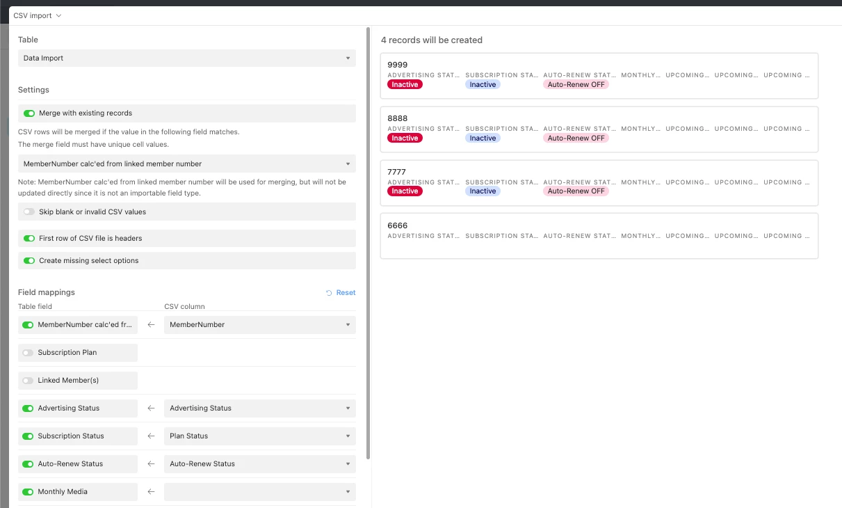

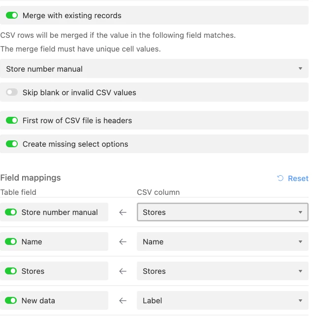

Thanks for the response, Adam! In my case, your Stores table needs another field: store name. And your primary field would be the formula that combines them into (store number) - (store name).
And in the CSV import, I need it to merge with the existing records, not create new ones. The merge is where the sticking point is. Screencaps below.

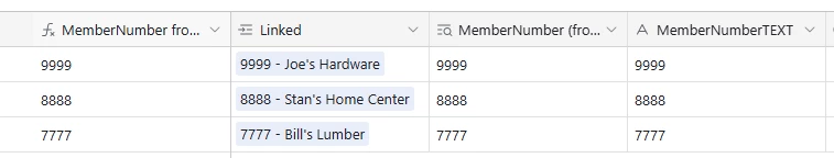

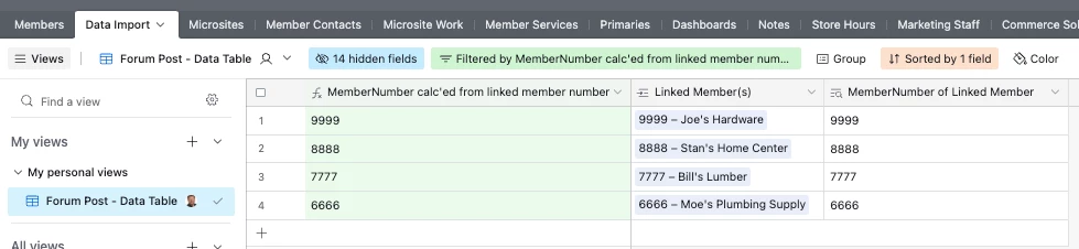

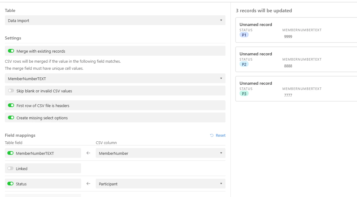

i think i might've figured it out - looks like the merge has issues with comparing to a formula. i added a text field type with the store name (you could either create a new field and run an automation or just copy/paste, or edit the formula field to be text and it retains the values) and merged on that - looks like it works if you do it that way.
Ah, so sorry, I completely misunderstood what we were trying to do, thank you for explaining!  Yeap echoing ibayub's idea of just creating a text field for this instead.  I tried setting the store number to go into both the linked field and the new text field for merging and it seemed to work fine
