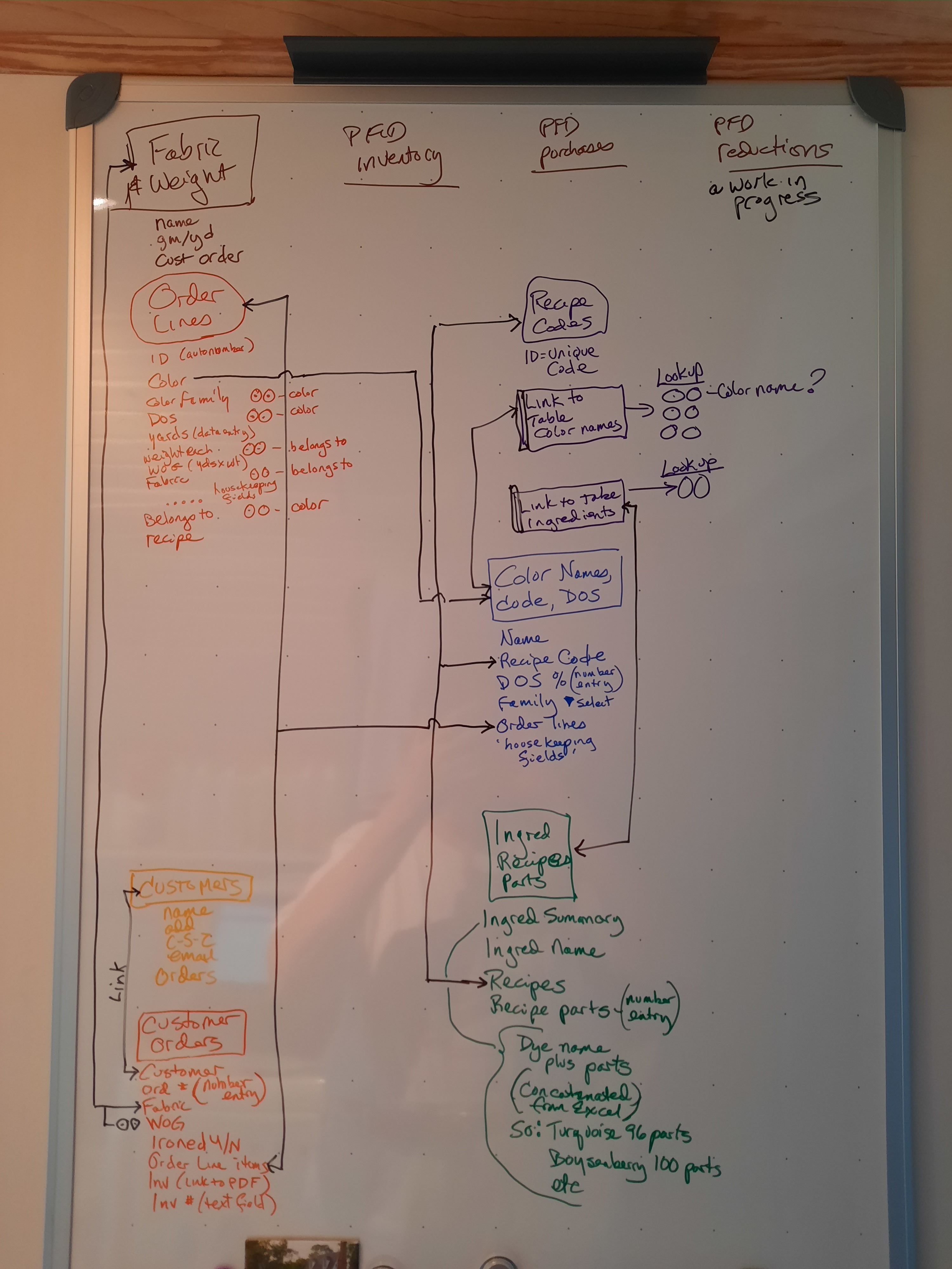

Hi - I dye fabric. I’m trying to get the right links to the right fields and have created a hot mess. I’m attaching the hand-drawn schema. One correction: Order lines: “belongs to” links to customer orders. To translate, black lines are links, double 00 indicates lookup.
Specifically:
The recipe called Mud = 50 parts blue, 30 parts yellow, 20 parts red. Right now the ‘recipe codes’ table shows the ingredients on one line, as written above. I need them to be on separate lines. Which they are in Ingredients | Recipes | Parts. Am I just linking to & looking up in the wrong table? Does the schema look like I should be combining the ‘Recipe Codes’ and ‘Ingredients | Recipes | Parts’ tables into one?
Edited to add: this is based on the structure of ‘Recipe Organizer.’ It works like that, but it turns out that’s not what I need.
Edited to add: Combining the two reciped] tables wasn’t the answer: I still get “blue, yellow, red” and “50,30,20” or blue 50, red 20, yellow 30.
