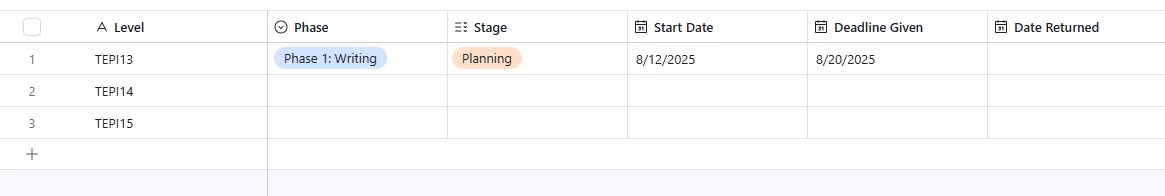

Table A is meant to be just an overview of the project. The start dates, deadline given, and date returned will be entered manually as they change often. Here is a screenshot of the relevant part of Table A.
Table A

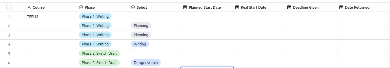

Now I’m creating Table B. In Table B I want to keep track of how long it took the team to finish each phase and each stage. Here is a screenshot of what I have so far:
You can see in Table B I will list each stage of a phase and I want to track the start and end dates for each stage. Ie it’s more detailed than Table A. I’m wondering if there is a way to capture the dates in Table A and put them in Table B. In Table A the “Phase” and “Stage” columns are Single or Multiple Select and will change as we progress through the phases. In Table B the “Phase” and “Stage” columns will not change because I want to capture the timeline for each stage in each phase.
So I want “Real Start Date” in Table B to capture the “Start Date” in Table A if it matches the same Phase and Stage. In other words, for row 1, TEPI13, when Table A is “Phase 1: Writing” and “Stage: Planning” the “Real Start Date” in Table B should show “8/12/2025”. But the phase, stages, and date in Table A will continue to change; whereas it needs to stay the same in Table B. So, I can’t just use “Lookup” in Table B for the start date in Table A, because it will continue to change. I also can’t use “If, then” based on the phase or stage, because as soon as the condition for “if” changes (for example, the stage) then it will no longer be true.

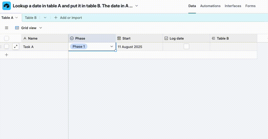

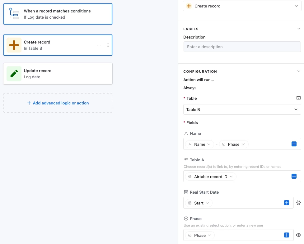

Hm what if you used an automation to help you log this?  In the gif below I’ve got an automation that triggers when the checkbox is ticked that’ll create a new record in Table B with the data copied over.  Not sure exactly how your data gets created, but the logic would be the same
  • August 11, 2025

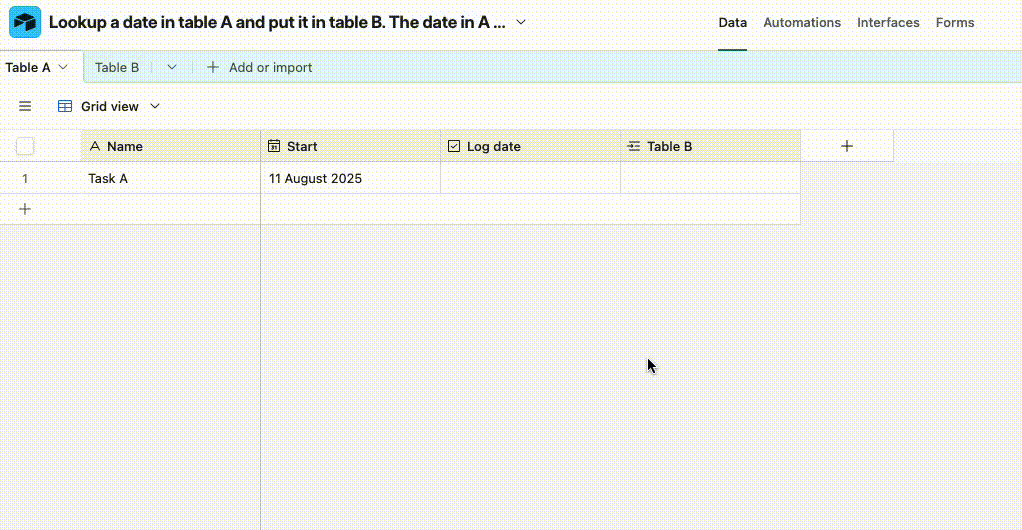

Hm, wouldn’t we just click the checkbox again in that scenario?  Sorry, I think I don’t understand something in the workflow!  Could you provide some example input and output data?
I also noticed an error in the previous gif and have corrected it!  (The date was set up wrong)
  • August 11, 2025
Yes, I see what you mean and that could work! Thank you so much!! I tried setting up an automation, but no luck. I can’t get it to show up on Table B. Could you please send me a screenshot of your automation?
Yeap sure, and here’s a link to the base too; you can duplicate it into your own workspace to modify it!
  • August 11, 2025
Thanks! Unfortunately it won’t let me edit or duplicate it and when I try to create the same thing in my tables, it doesn’t work. I’ve been able to add a record to Table B, but it doesn’t automatically include the date. It only gives me the level or name.
