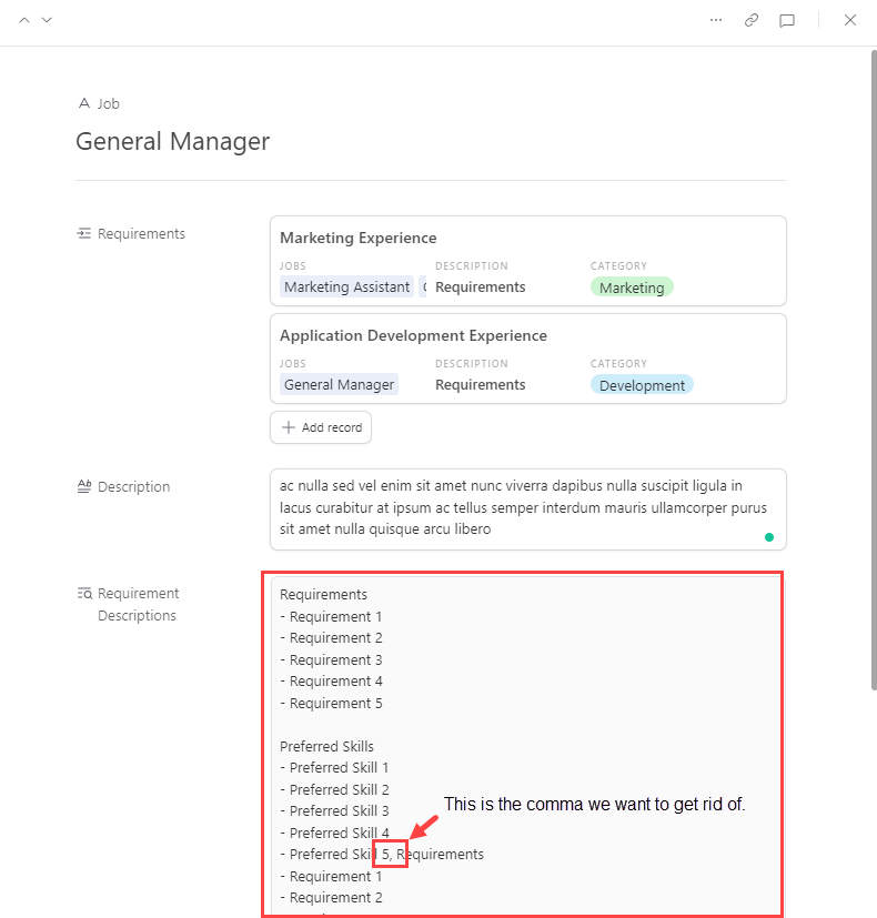

I first created a lookup field which, as expected, displayed the comma behavior that I presume you're running into.

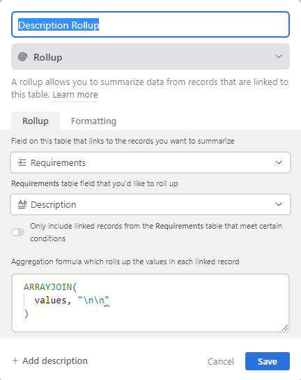

I'll go ahead and create a rollup field that points to the field that we were previously referencing in the lookup field. Here's the rollup formula that I'll use for my desired outcome:
ARRAYJOIN( values, "\n\n" )

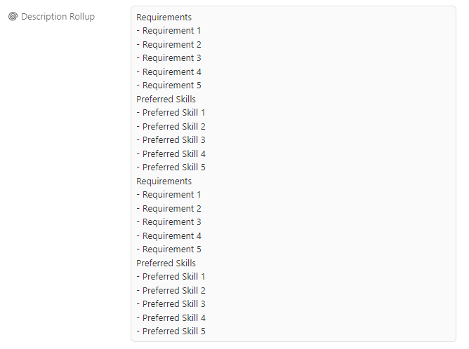

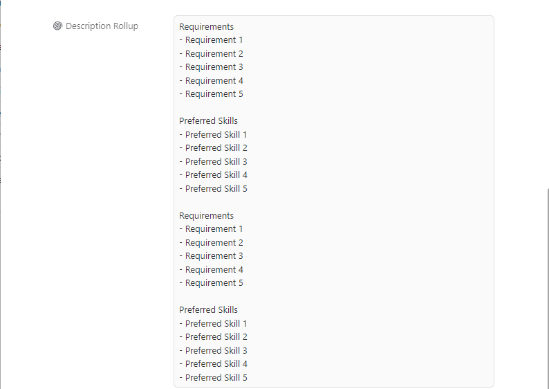

Here's what the final result looks like:
The ARRAYJOIN() function allows you to define a custom separator for array elements. In this case, I've defined that I want each element to be separated by two new-line operators ("\n").
You can switch the separator out to fit whatever you want your formatting to look like.

For example, if I wanted to remove all the of the excess whitespace between the Preferred Skills and the Requirements, then I could use this formula:
IF( values, REGEX_REPLACE( "" & ARRAYJOIN(values, "\n"), "\n\n", "\n" ) )
