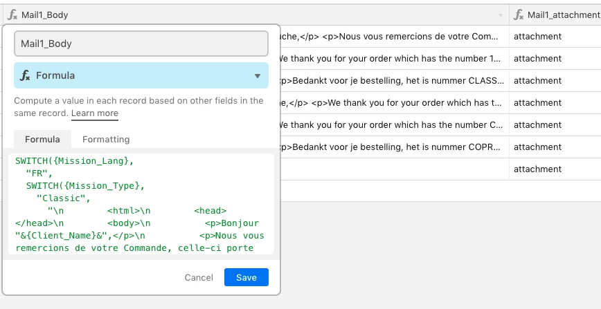

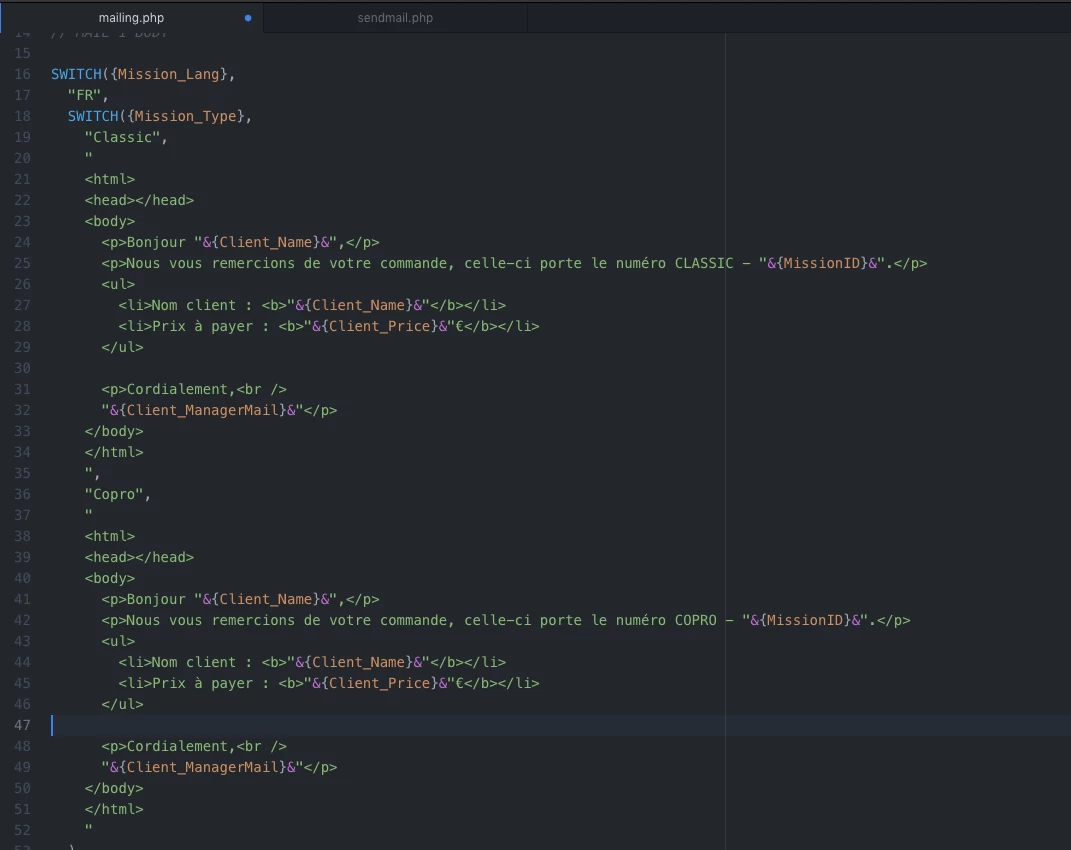

I’m about to change the strategy to conditionally format e-mails templates directly in Airtable in a Formula Field.
This formula with look like :
SWITCH ( Product ,
“Classic”,
SWITCH ( Lang ,
“FR”, ‘Mail template…”
“NL”, ‘Mail template…”
“EN”, ‘Mail template…”
“Copro”,
SWITCH ( Lang ,
“Office”,
SWITCH ( Lang ,
Of course “Mail template” will be a HTML formatted, including variables, etc…
My questions are :
  • Considering the size of the potential formula (I already made a valid test with 9 branchs and 40.000 chars total), should I anticipate issues ?
  • Would you recommend an other strategy ?
Thank you very much for you advices,
Regards,
Pierre-Louis

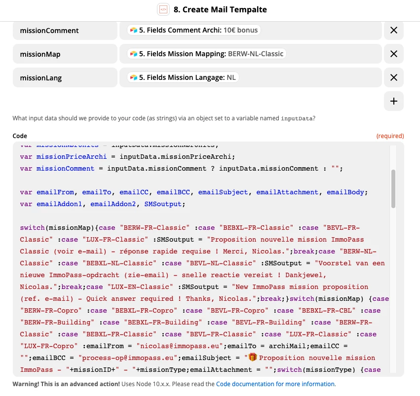

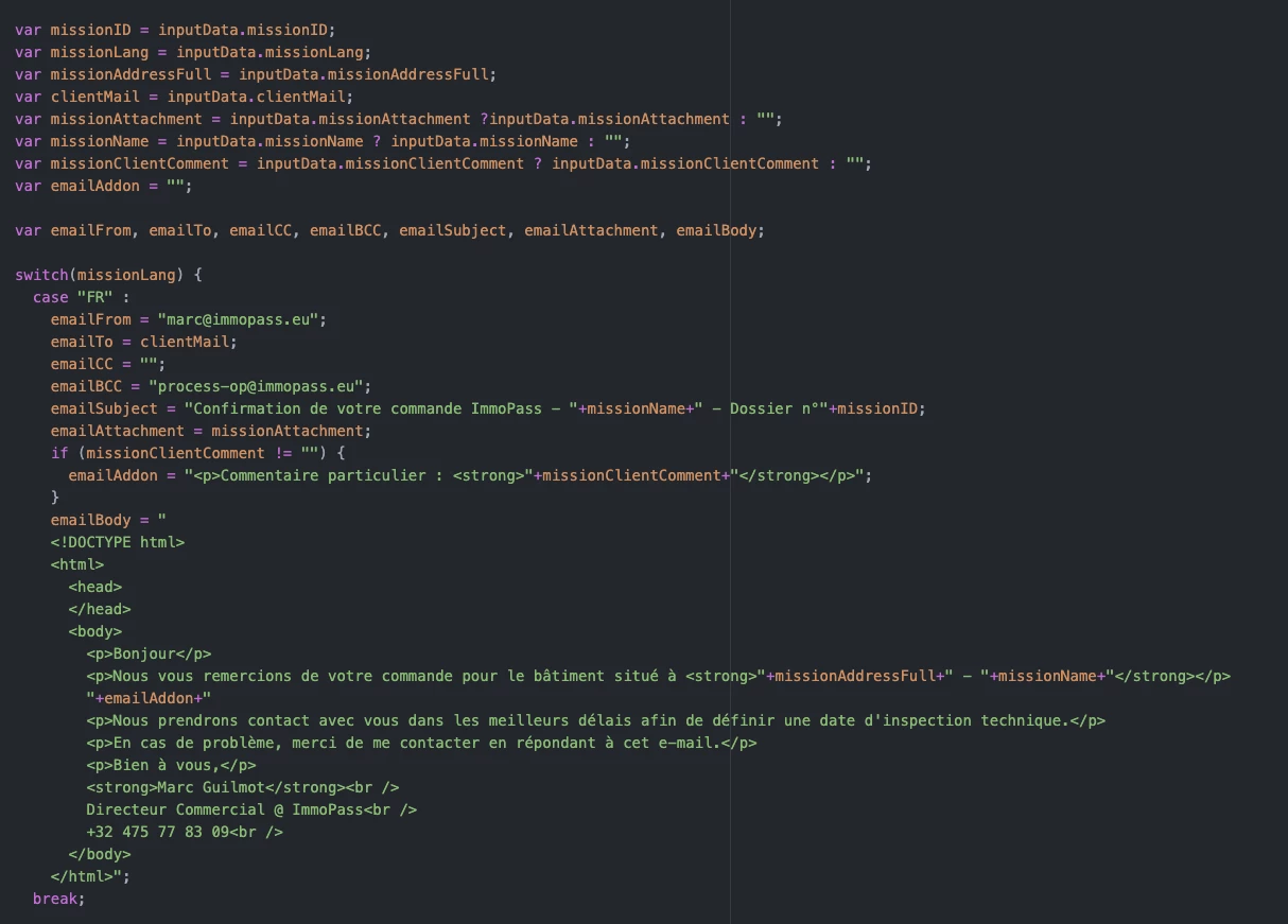

Best answer by Pierre-Louis_Fi
For those who are wondering which solution I chose for managing multiple mail templates : Code by Zapier > Run Javascript with templates included in a code file with a switch() on mapping (to select the correct template.
I use outputs in the next mail block :
I keep all the Template code in a file like this
I then use
Please feel free to ask me if you have any question.
This solution works like a charm and is very flexible.

SWITCH (Product ,
  'Classic',
  SWITCH ( Lang ,
    'FR', ‘Template A'
    'NL', ‘Template B'
    'EN', ‘Template C'
  'Copro',
  SWITCH ( Lang ,
    'FR', ‘Template D'
    'NL', ‘Template E'
    'EN', ‘Template F'
  etc, etc,
It is possible that, depending upon your requirements, you might only need 3 templates (one for each language) and all of the variables - product, price, description etc, along with the Template name, are passed to the SendGrid API as variables.
There’s nothing wrong with the set-up you have now (Airtable -> Zapier), but as it gets more complex, it feels like there is a good argument for putting the right things in the right places and generally a service like SendGrid would be the place for the email templates.
Hope this helps.

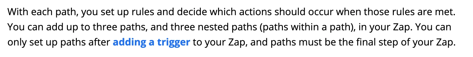

If you stick with Zapier paths for now, I think you can get up to 18 endpoints:
3 paths, each with 3 nested paths (so 9) and each final path offering a binary outcome, so 18 in total.
Even with this set up, you might find that it makes more sense (and is easier to manage) if the HTML templates are in Zapier rather than Airtable, but this does depend upon your specific case.

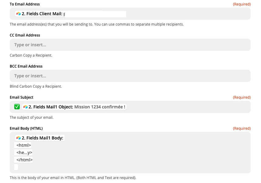

Hi again,
Actually, I’m gonna get rid of Zapier Paths, because of mid-term limitations and heavy maintenance costs.
The idea is to have a straightforward Zap with 1 block for sending an e-mail. In this block, I will input the Mail Body in one unique variable that will be generated inside Airtable (Mail1_Body, which is a formula with SWITCH(SWITCH…) that will render the HTML body I need.
This simplifie all my process.
I’m only annoyed by the fact that I concentrate every templates in a Field Formula :
You see that there will be a lot of information in this formula (I already made a working test with 9 endpoints with a total of more than 40.000 chars, which is already a lot and more than necessary)
Content of the formula is obviously generated in a separated developper text edit software, then I copy/paste is in the Airtable Formula when I need to modify something.
It works, but it’s not a very elegant solution (but better than 3 nested paths in Zapier actually).
I’m worried that I’m pushing the Formula Field into its own limits…
May I face unexpected issues working like this?

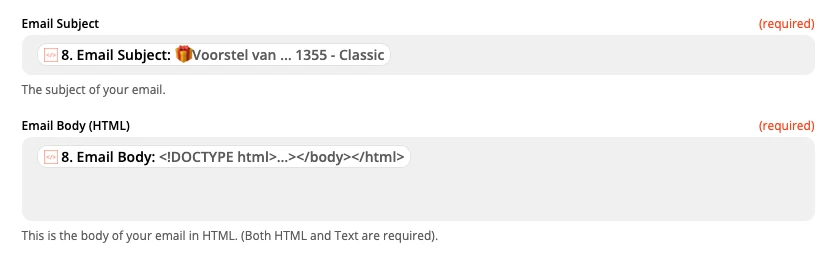

I then use

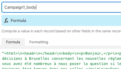

Hi! Pierre-Louis_Firre, did you add the HTML code into Airtable so you could use merge fields from Airtable records before sending the final code to Zapier? I’d like to manipulate the code in Airtable using IF Statements (if possible) then send to Zapier via a button (webhook) which would connect to Outlook and add an email into my drafts folder. But for some reason I can’t get the HTML to save in the formula field even with " " around it. Thoughts?
Forum|alt.badge.img+8

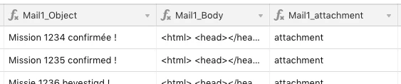

Hi Lindsey,
I’m still using HTML directly into Airtable field for some mailing business.
It works properly without any issue, like this :
Could you share some screenshots of your issue?
Hi Lindsey,
I’m so sorry I somehow missed your reply message! I wasn’t able to use a webhook because my HTML was above the amount of data that could be sent. So instead of a button, I used a checkbox to trigger that record into a new view which would trigger the email in zapier. Your post helped me SOOOOOO much! It seemed totally possible but I honestly wasn’t finding any use cases where someone was using airtable data as intensely as I needed to create the email. This solution saved me 3+ hours of work each day. I’m very grateful you shared!!!
Excellent ! Thanks for you feedback, I’m very glad it helps you!
