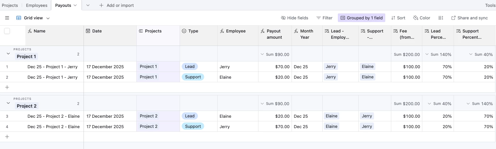

Try creating a table called ‘Payments’ and use an automation that’ll trigger once a month for this.  The automation would:
  1. Look for all active Projects
  2. Create two records in Payments, one for the Lead and one for the Support
Here’s how it might look in action, and I’ve set it up here for you to check out
Here’s screenshots of the data so you can review it!
It works by using formula fields to determine what kind of Payout record it is, Lead or Support, and then using a Switch to pull in the correct employee name and percentage amount
I added in the ‘Percent check’ thing as that seemed useful to me, and that field basically checks whether the percents add up to 100%.  I put the percent fields in there as you mentioned they sometimes change
I’d also suggest refining the automation so that it stamps the values in instead of just using lookups as well.  Right now if you change the Fee value in Projects, all the historical Payout records will update as well due to them working via a lookup, and stamped values would fix this vulnerability
