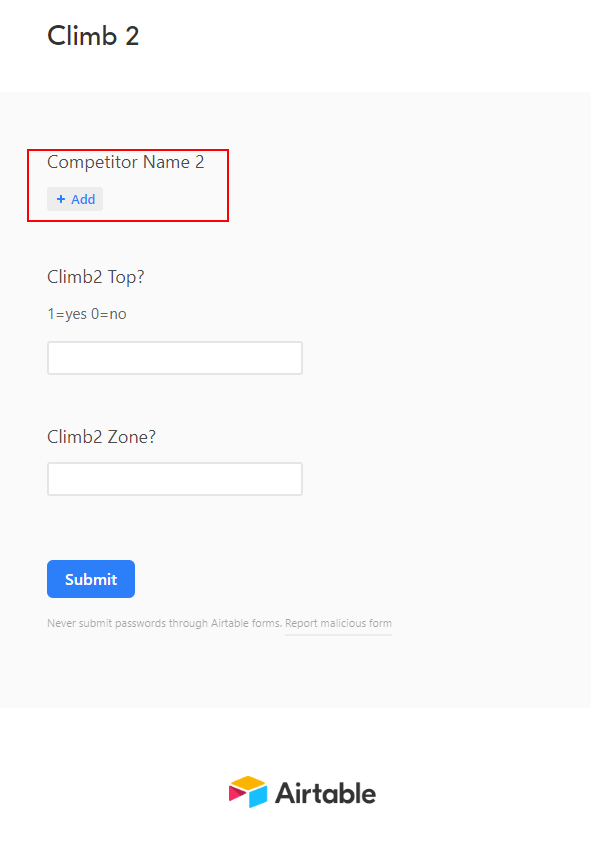

I think my main issue is trying to get the competitors name to be available via “dropdown” instead of typing it in. I used a field linked to the names in one of the tables. This enabled me to choose from the list of names. But when the form was completed, the name wouldn’t populate in Updates.
This is my form:

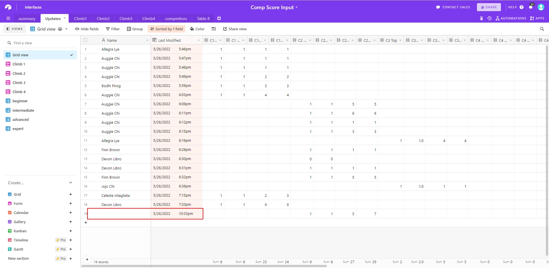

And this is what the entry looks like without the name:

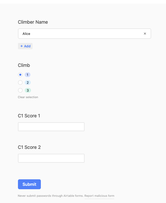

Hey James, I think if I were you I’d set this up with a linked field instead.
Consider the following:
  1. Table 1 is called Compiled Scores and each record will be a single climber and will contain all the scores
  2. Table 2 is called Judge Submissions and each record will be a submission from a judge
The workflow for judges would be to select the climber as well as the climb that they are judging, and then input the scores. We would have a single select field for them to pick which climb it was, and we would show the appropriate fields once they select the climb.
E.g. if they select Climb 1, they will only be shown the score fields applicable to Climb 1
The climber field would be a linked field linked to the Compiled Scores table.
We then use a bunch of lookup fields to show everything we need to in the Compiled Scores table
I’ve set up a base for you here and you can duplicate it to customize it.

Amazing, works perfectly! Thank you!!!
