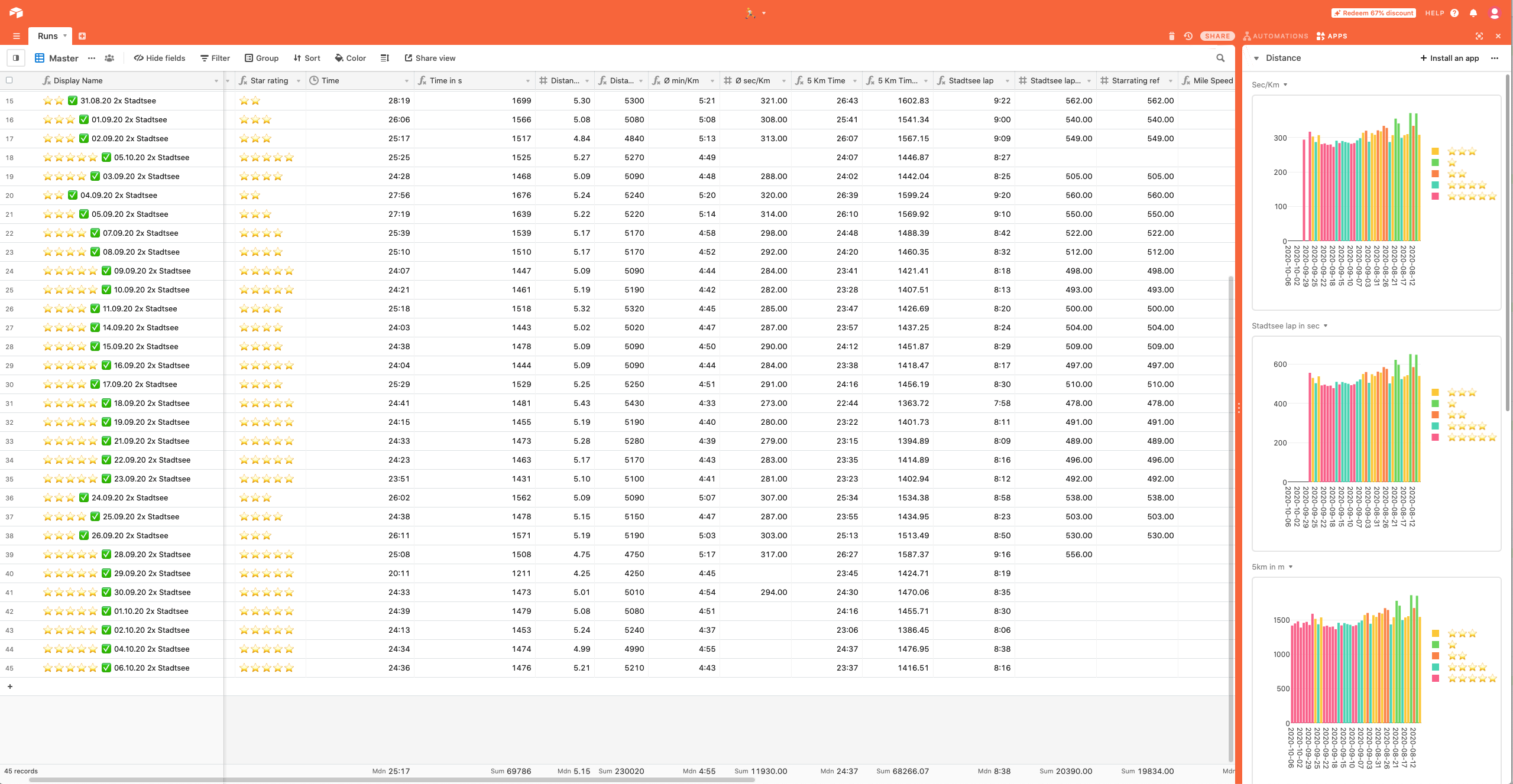

Firstly, here’s the base:

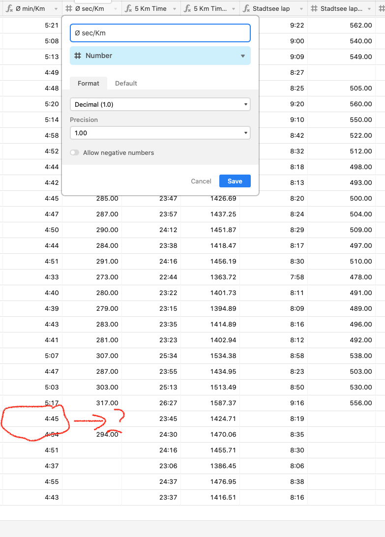

And here’s the first instance of numbers not converting (copying, as the field is a duplicate) from mins to sec…
Let me know if you need more!
Julian_E_Post
Forum|alt.badge.img+14
Sure!
I think I see what’s happening - let me know if this sounds right to you. The “Number” field type does not support formulas. In other words, if you switch from “Formula” to “Number”, it will stop calculating, and become a static field. If your intention is to convert mm:ss to seconds, you can do that with a formula!
Is your min/Km field is formatted in mm:ss? If yes, make the sec/Km field a formula field. Then just put the {min/Km} field into your formula without any calculations. It should automatically show the units as seconds.

Simple answer: change the sec/Km field to a formula, and enter {min/Km} as the formula. See what happens!
  • October 8, 2020
Brillant - thanks!
I think I thought a chart couldn’t reference a formula - guess I was wrong!
