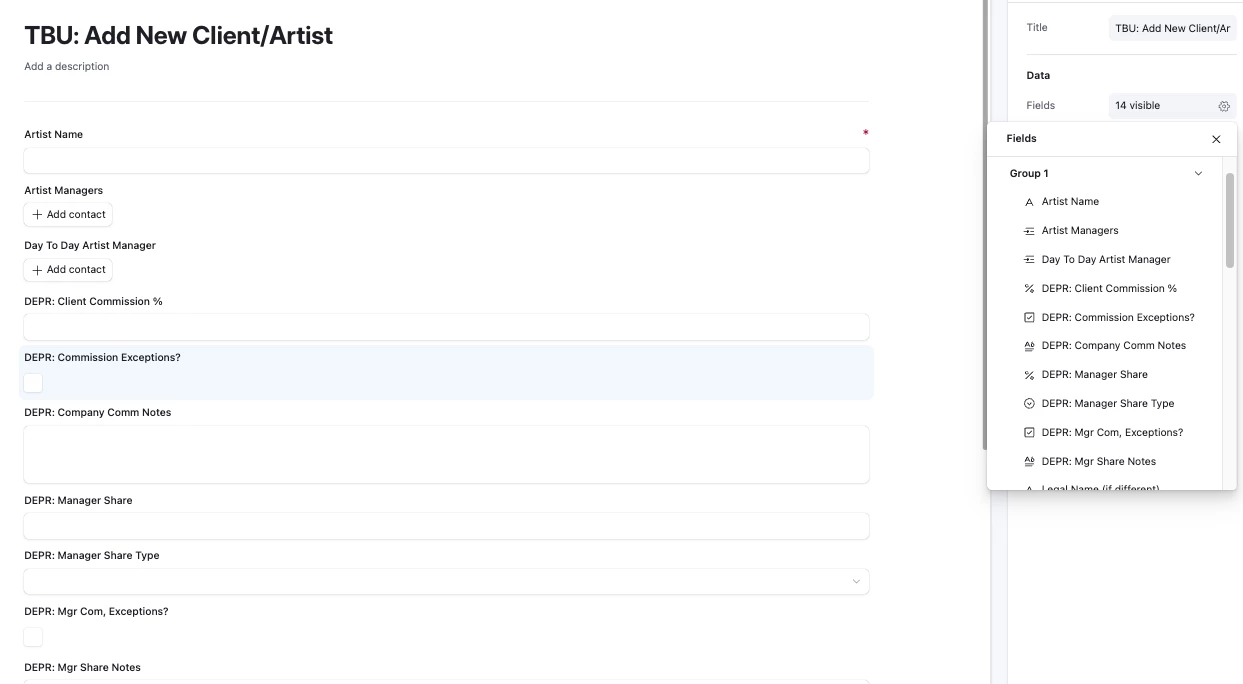

I am going through something similar with one of our bases. Here are some things I am doing that have been helpful for preserving existing functionality and building/improving the plane while flying.
  1. I never delete columns. If I don’t want to use a column anymore, I will rename it to have “DEPR:” in the beginning, standing for deprecated. This makes it easy to avoid selecting those when building interfaces, new rollups, etc. It also makes it very easy to see these fields for removing them from existing interfaces.
  2. I also do the same for tables and then you can also hide these from navigation in the base layer.
  3. When I am deprecating a field, it usually means I’m making a new one that is better. When that cleanup happens, I’ll hide everything, but the deprecated field and the new one and i will sort by the deprecated one. Then, I will make sure to populate the new field based on the old field, but NEVER delete from the original deprecated field. It’s always good to have that to look back at just in case.
  4. I use these abbreviations a lot and it really helps myself and users in tune with changes going on in between official notices of updates:
    1. TBU: To Be Updated
    2. WIP: Work In Progress
    3. DEPR: Deprecated
    3. DEPR: Deprecated
