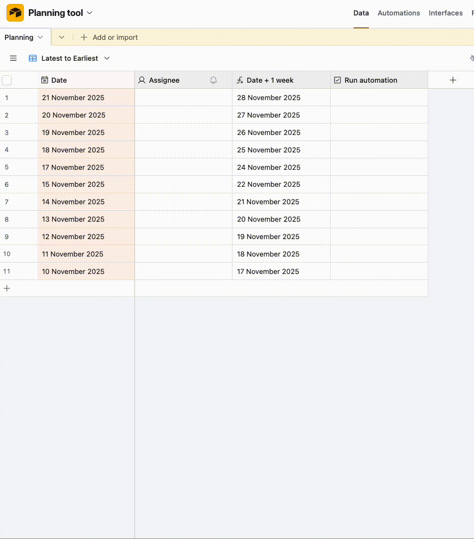

I’ve created an example base here that assumes we want to create 5 tasks per week, one week in advance and here’s a gif of the automation being triggered via a checkbox

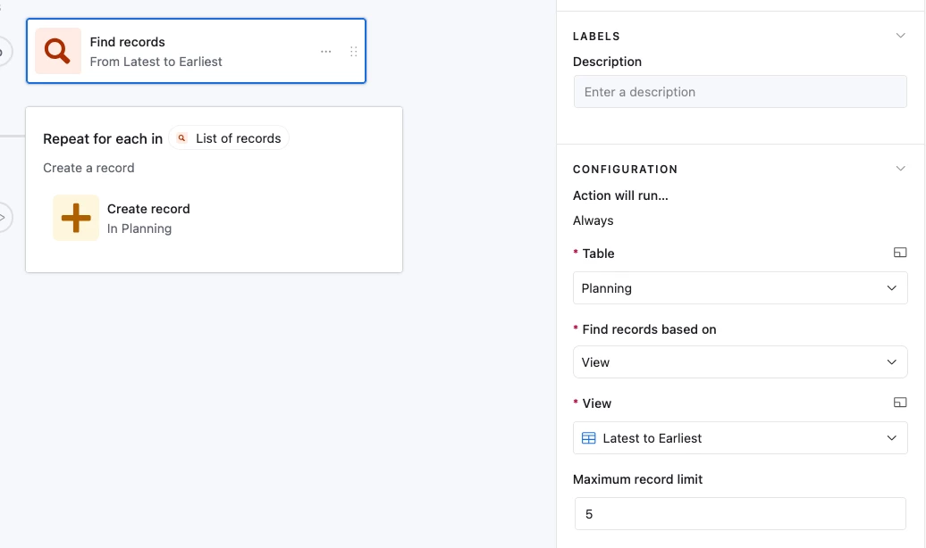

  2. Look for the latest 5 Task records
    1. This is done by using a Find Record step like this:

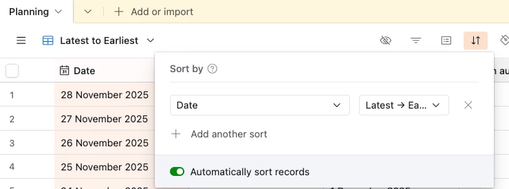

    2. We set the maximum record limit to be 5 to grab the latest 5, and the view ‘Latest to Earliest’ is sorted by date descending:

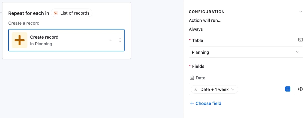

  3. We then add a Repeating Group step that will create one record per found record and with the new date:
    1. And the field ‘Date + 1 week’ is set up as. formula field that adds 1 week to the current record’s date:
      1. DATEADD(Date, 7, 'days')
