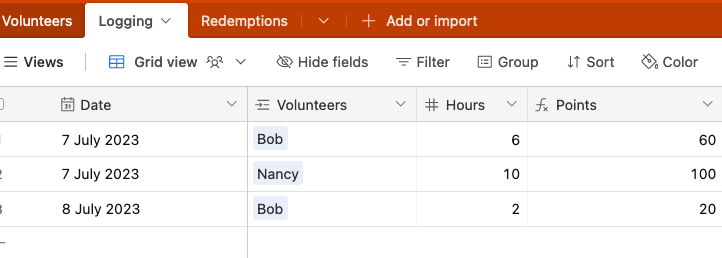

A "Logging" table to log how many hours a volunteer did, and a formula field to calculate what that is in points:

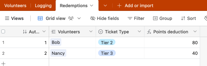

And a "Redemptions" table to set which person redeemed what type of ticket, plus a formula field to represent how many points that is:
