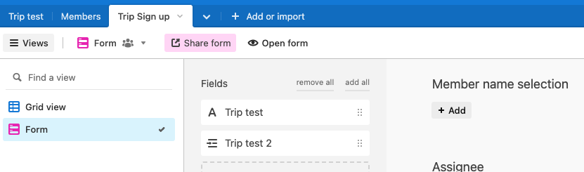

Trip sign ups is a sign up form where a member selects which member they are in a form (from a look up of the Members list)
Which ends up looking like this in grid view

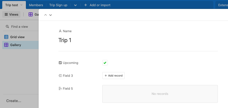

I am trying to create a view in Trip Test that pulls in and shows which member has signed up for each trip (preferably so that member can also be clicked on to show additional info like their photo). All I’ve ended up with though is another selection field to choose those members rather than pulling those that have already signed up.
The hoped for behavious is that field 5 in the Trip Test gallery/table displays information that’s in the 2nd column of Trip Signup.

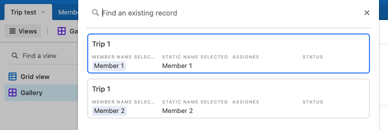

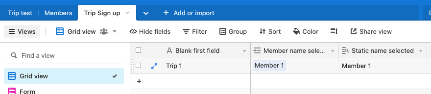

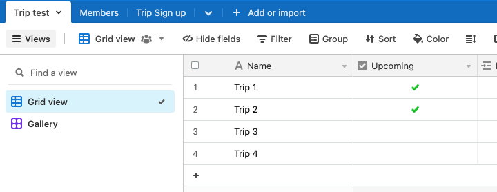

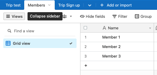

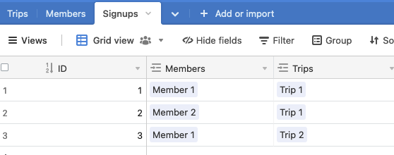

Hey, I’ve put something together here for you, but I’m not sure if it’s what you’re looking for

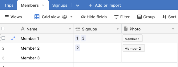

Members table:
Sign ups table

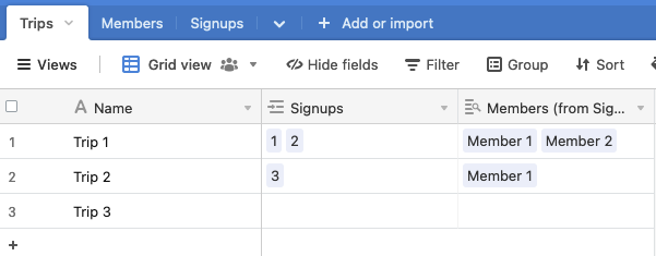

Trips table:

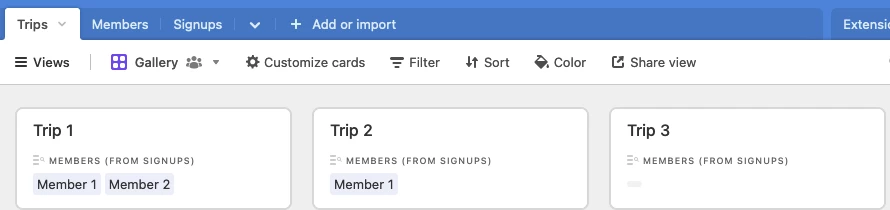

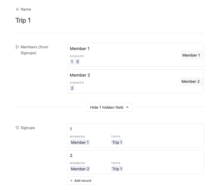

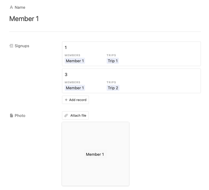

Trips table, gallery view:
Trips table, gallery view, Trip 1 clicked:
Trips table, gallery view, Trip 1 clicked, then Member 1 clicked:
