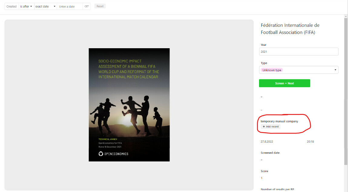

Hi there @Adam_TheTimeSavingCo I am currently using a workaround, but i was asking if it was possible to avoid that, to do it natively.
Your workaround seems unnecessarily complicated if i understand it correctly. I simply added a second link field (“temporary link field”). Whenever someone links a record via this field, an automation is triggerred which will simply take that link and overwrite the original link field with that link. No need for more buttons or checkboxes or so…
PS: to clarify: the interface i build (using airtables “interface” feature) is used for screening and verifying records irrespective of this re-linking issue. the fact that a record might be linked to a wrong record in a different table is just one of the checks that the people screening the records are doing. the interface is not solely for re-linking, it is for screening records in general.
