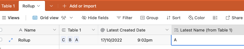

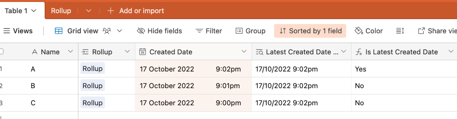

You're on the right track, you'll just need to use `MAX()` slightly differently.  Here's an example to get you started
To recreate the base above:
1. Have all the records linked to a single record called `Rollup`
2. In the `Rollup` table, create a rollup field on the `Created Date` value from `Table 1` with the formula `MAX(values)`
- This will give us the latest date  
3. In `Table 1`, create a lookup field to pull over the most recent` Created Date` from the `Rollup` table
4. Use a formula field to check the `Created Date` value against the most recent date pulled in via step 3
5. In the `Rollup` table, create a lookup field with a conditional that checks against the field from step 4
