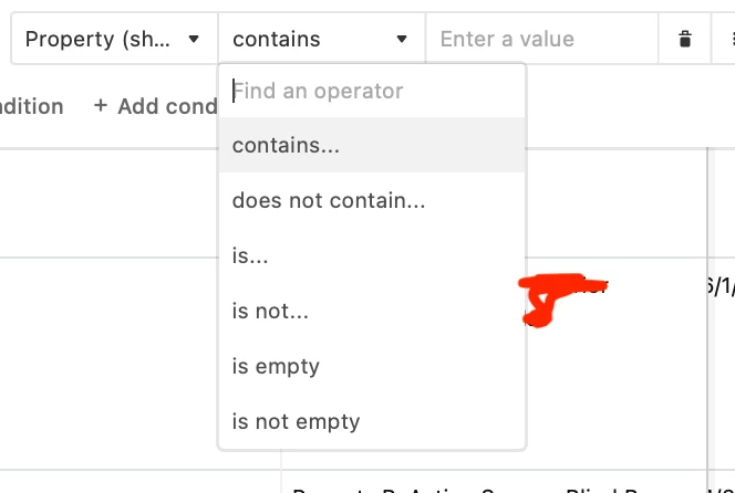

After making the update, the primary table that holds this field allows for the filter to work properly, as attached.
However on the secondary tables that hold the lookup field, I'm not seeing the filter options change. Creating a new view/filter presents as if it were still a text field, with no options for "is any" or "is none of".

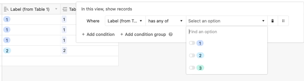

Weird, I just converted a text field into a single select and added a lookup for the single select like you mentioned and it works fine for me; I have a "has any of" etc option for the filter on the secondary table
Might want to open a support ticket! 
