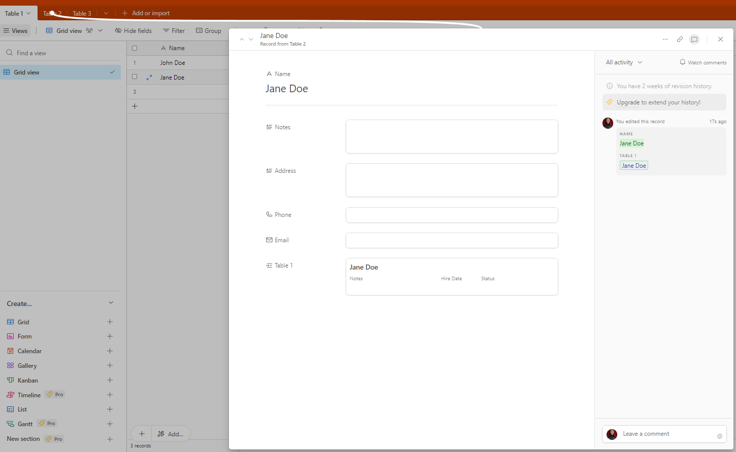

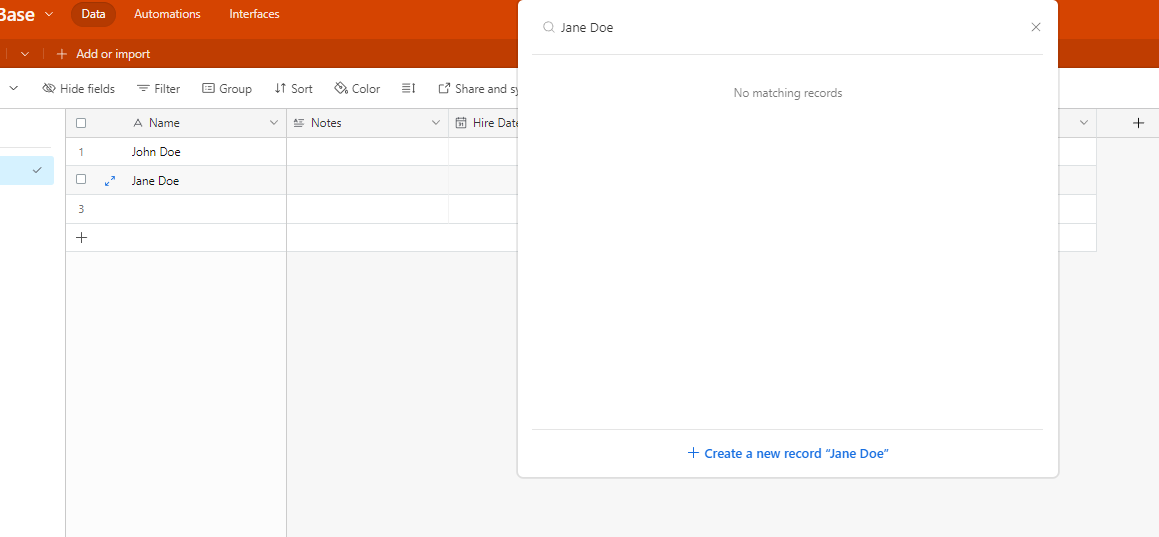

Yes and no. I would work from the "main" table and just think of it as each table being a different page of info.
Say you start entering your info on the main page, then when you get to the Table 2 field (ie Personal Info) you put in their name. Nothing exists so you click on 'Create New Record "Jane Doe""
This creates the new record in Table 2. Click on that directly and it brings up the Table 2 record info. You don't leave Table 1, just click on the new name button in the Table 2 column. Fill that new window in.
Click the X or just outside that window to close. Repeat that process with Table 3 (ie work history)
Now all of the pertinent information is in your database, separated into more easily managed sections. And you never really 'left' Table 1. The important thing is to remember that this is a relational set of tables, and everything connects.
