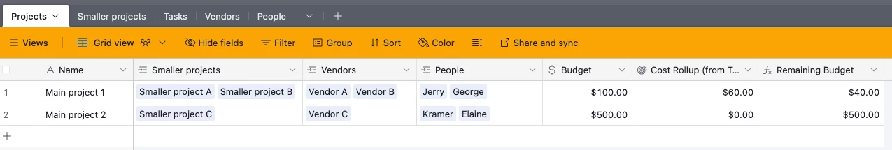

I built a base here to get you started, and you can duplicate it to your own workspace to play around with it!
It has a Projects table where you link each project to the smaller project and the associated vendors and people:

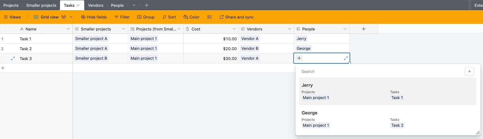

Smaller projects table where you can create tasks per smaller project (not sure if you needed to also create tasks per main project though)
And in your Tasks table you can use conditional linking to only allow selection of people / vendors that you’ve already associated with the Project for this task.  As you can see below, for task associated to ‘Main project 1’, Kramer and Elaine can’t be selected as they’re associated with ‘Main project 2’, does that make sense?
