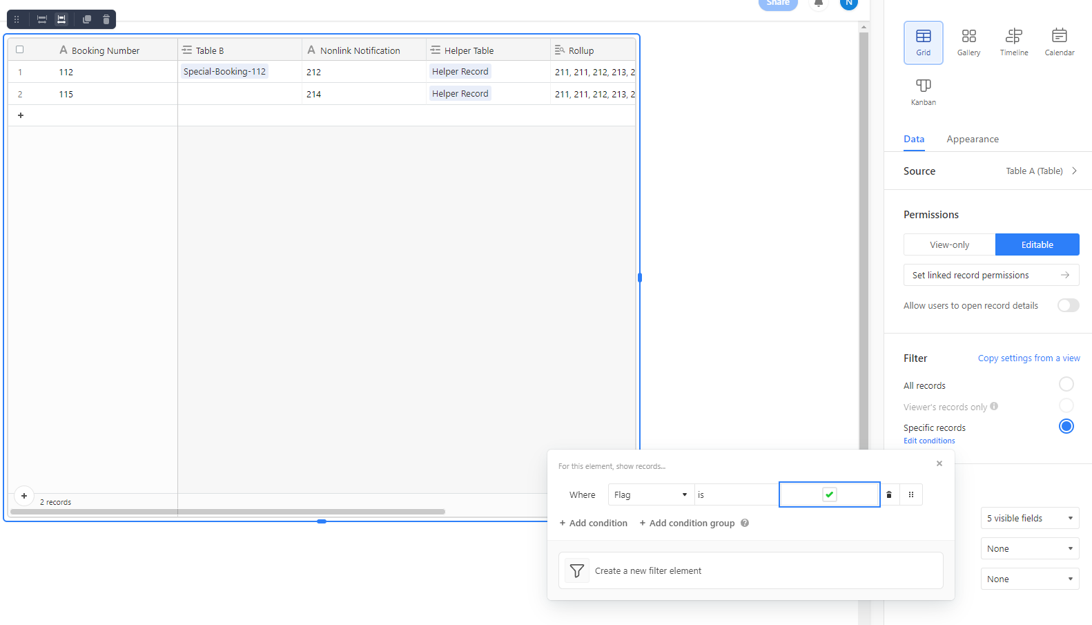

There are a few ways to do this. One straightforward solution would be to create a new Interface page.
  • Add three “Grid” elements to your interface page.
  • Configure each of the grid elements to use one of the tables as its Source
  • To filter your grids by the Flag field, select “Specific records” under the Filter configuration for the grid and then add the condition Flag is checked (or equivalent)

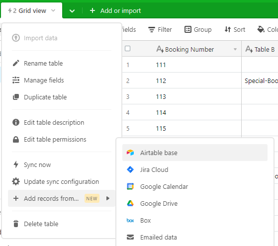

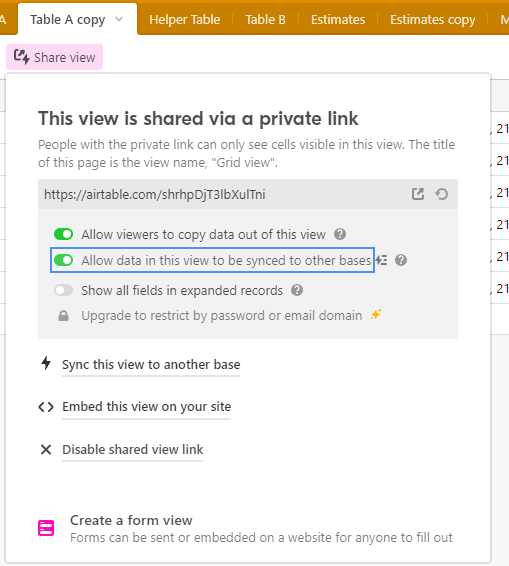

[Pro Plan required] Airtable Sync to a new base
  • In each of your three tables, create a view that filters down to only include records with “Flag” checked
  • Create a new base
  • Inside the new base, create a new table with “Add data from other sources > Airtable base”
  • Select your original base, the first table to sync, and the filtered view. You will flip the setting (on each source table) to allow them to be sync’d to other bases
  • Once you’ve set up your first sync source, go into the table dropdown and “Add Records From > Airtable Base”
  • Now set up a sync from your 2nd source table. Airtable will prompt you to map your columns so you can decide how the data from each table should be merged together
  • Repeat for the third table
