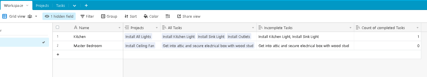

I still am a little stuck despite the helpful example you gave. Maybe it’ll help to clarify what I’m trying to do by expounding a little. Here’s what I’m looking for:
House Overview
Painting Lighting Flooring Plumbing Shoe Finish Work Cabinets/Countertops

    At the top, I have my House Overview. We’re in the lighting stage of the house renovation. From there, I’m looking for a way to have an individual subset of tasks within a project that is not connected to tasks within another project. Same thing with the projects. I want a different set of projects within that specific workspace that won’t get mixed up with other projects in other workspaces. I would like to be able to view this all in one Workspace Table. Is this available in a free Airtable plan? Can you help with this? I hope this was somewhat clarifying, not confusing.

Hi @James_Campbell,
All plans in Airtable can do what you are wanting to accomplish.
Create a table called workspace, list them all per row.
Add a field, link to another record, create table Projects
Open the Projects table and rename it, List all projects per row
Add a field, link to another record, create table Tasks
Open the Tasks table and rename it, List all tasks per row
Open the Projects table and link the Tasks to the corresponding Project
Open the Workspace table and link the Projects to the Workspaces
Now you can use Roll Ups and Counts to show you incomplete tasks at the Workspace level (I am on the free plan)
