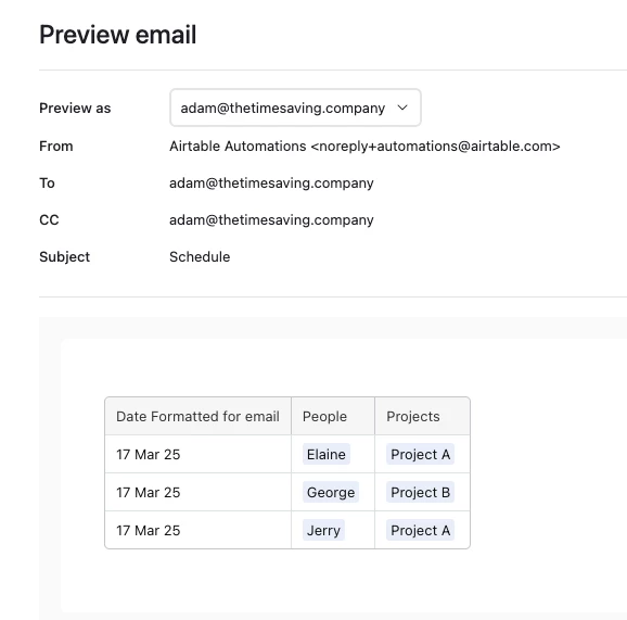

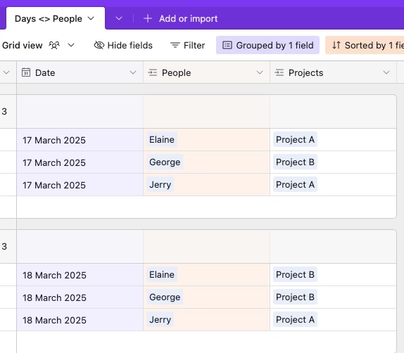

It feels like you’d need a table where each record represented a single day for a single person, and that way you’d be able to link that record to the project they’re working on for that day, and I’ve set it up here for you to check out!
Your resulting automation would look something like this:
And here’s the email:
