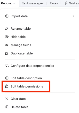

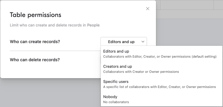

Hm, a quick way you can try to prevent this using Table Permissions (screenshots below).  That way the beginners won’t be able to create records at all, and you can create a Form for them to do that if they need to
This is a bit clunky because you’ll need to create one Form per table and make sure everyone knows where the forms are.  For that, try creating an Overview type Interface and putting all the Form links in there
