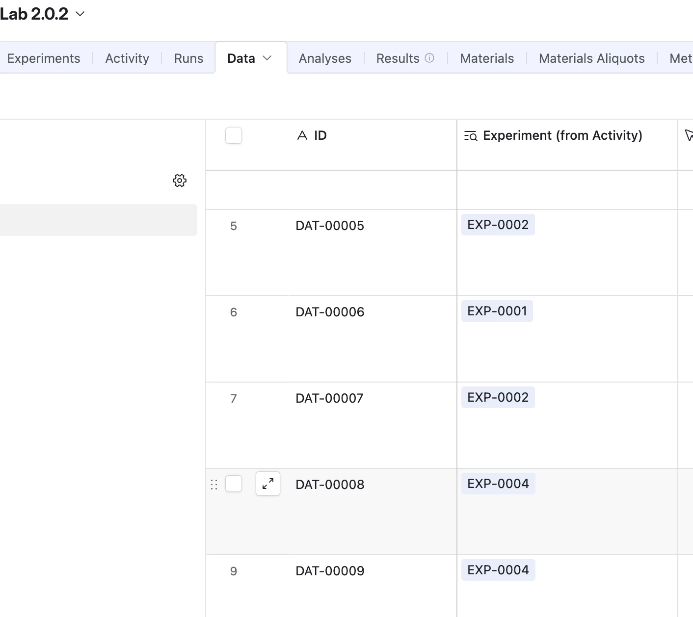

Here is table Data, which has its own lookup field from ‘Activity’ to Table Experiment

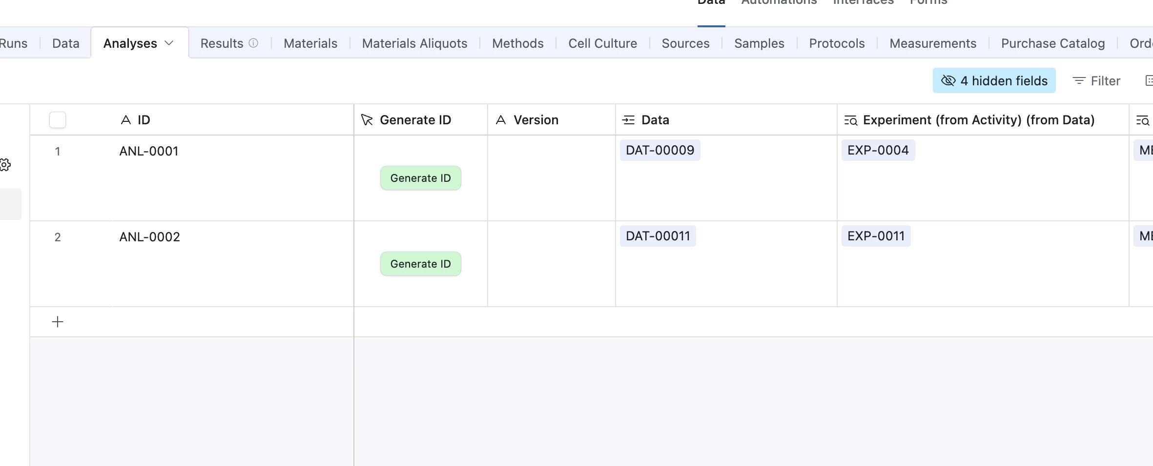

Then in table ‘Analysis’ I do a lookup of Experiment from linked record to Data, which AT automatically called Experiment (from Activity)(from Data)
What I want to do now is call a lookup from that Experiment (from Activity)(from Data) lookup field. I don't think AT permits that. Basically, I want to pull in another field/property of Experiment through a lookup. If ‘Experiment’ were a directly linked record, that wouldn’t be a problem. But since that record is itself a lookup, I don’t have that option.
