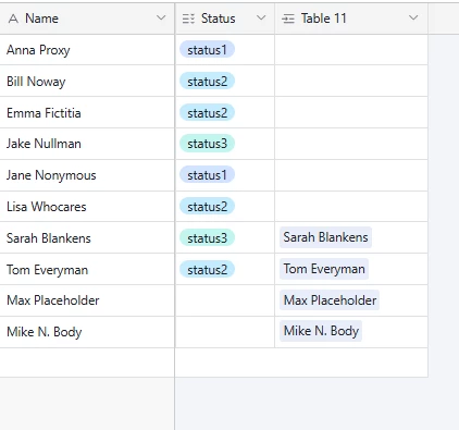

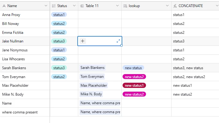

Is it correct that ‘newer’ table has staff already present in Full table, but with new statuses? What do you want to do with them - replace or append to old statuses?

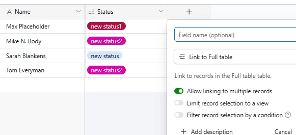

In short, you should link them to a Full table
Then you can see which are linked to existing and which are new created
Note that PRIMARY FIELD used to define where to link. If you have comma in your name(s), you will need additional step to link, because  it will count the name as 2 different values
After all, you can add lookup field and do what you want.

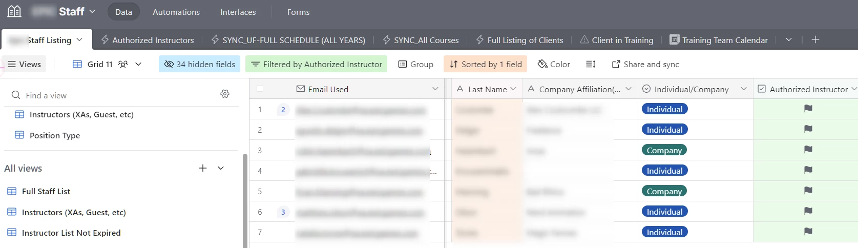

I have this as the original source, that I’d manually added authorized instructors.  Since then, another team has created, and I synced their table, of authorized instructors.  The first is my main source that many automations, and bases use.

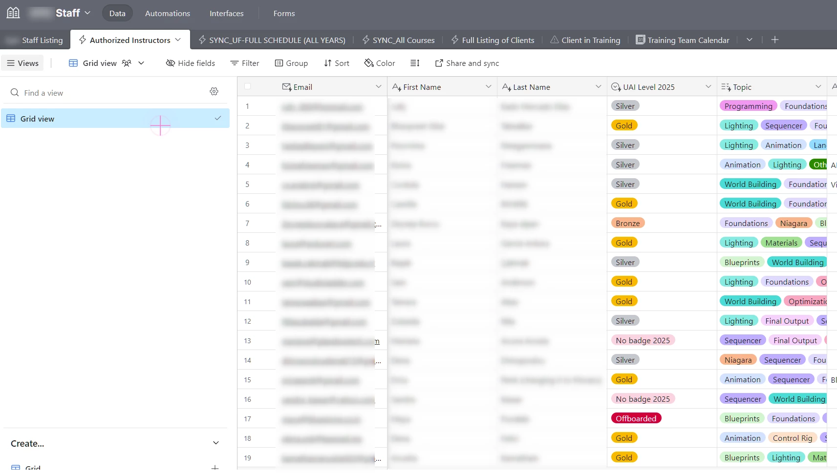

Second image below is the “new” table with the authorized instructors.
The source, staff listing is the main one, so I’d need to get the info from the “new” table into the main source.
