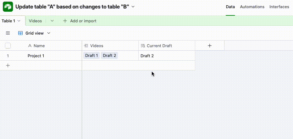

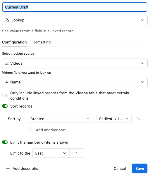

Hm, if you’re comfortable with using the creation date of the draft video as a proxy for ‘latest’, then you could use a lookup field for this:

I got this work with some help from Perplexity AI. I think we did something along the lines of what you suggest. I am able to pull in the name of the latest draft into the project record. I was hoping that once that draft record was referenced into the project record we could also then pull in additional fields from the draft record, but the AI was saying that I would need to repeat the entire lookup process for each desired field.
If I recall the process was to first use a rollup to figure which draft is the “’latest” draft in the drafts table, which gave me the date/time of the latest draft in each draft record.  Then I had to find the name of that draft record by doing a formulas looking for which draft matched the “latest” date/time. Then in the projects table I did a rollup using the  arraycompact of the formula field in the previous step.
The result is I can now see the name of the latest draft (if one exists) for each project in the table.
