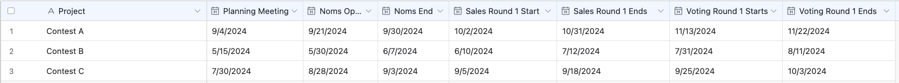

I have a Contest Definition Table  that is capturing specific dates related to a contest.  I have start and stop dates for about 5-7 different stages of a contest, so Nominations Open, Nominations Close, Voting Opens, Voting Closes, etc.

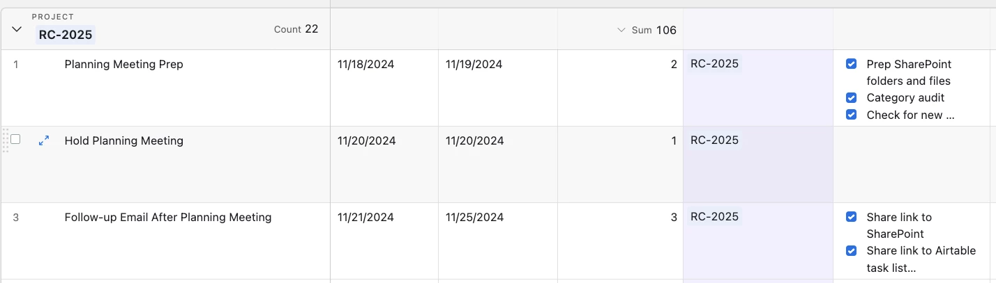

I have a record template set to create a set of tasks in a separate Tasks table for each contest based on those dates. The tasks are linked to the Contest Definition Table, All of that works just fine.  Each task has it's own Start and End date. There are actuals tasks for Open Nominations, and Open voting which is set based on dates designated in the Contest Definition Table.
What I am having a hard time figuring out is how to update theTask dates when dates change in the Contest Definition Table.

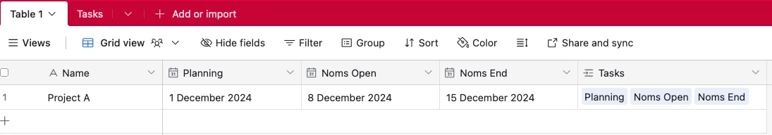

In the Tasks table, what if you used lookup fields to pull over the dates and create a formula field to consolidate that data?
The formula field would check what the name of the task was, and based on the name of the task would display the date from a specific lookup field.  You'd lose the ability to modify the dates from the Tasks table though
SWITCH( Name, 'Planning', {Planning (from Table 1)}, 'Noms Open', {Noms Open (from Table 1)}, 'Noms End', {Noms End (from Table 1)} )
