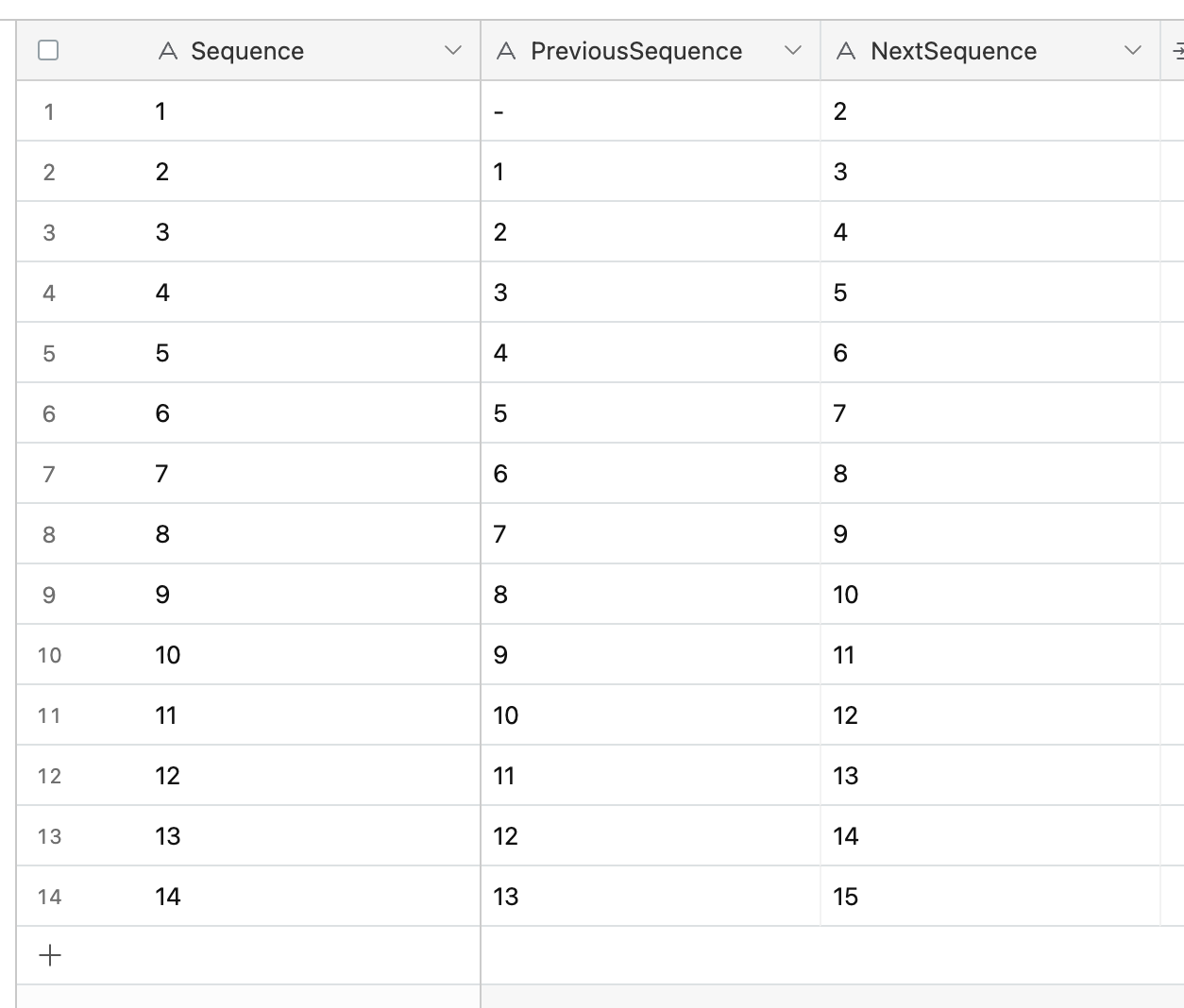

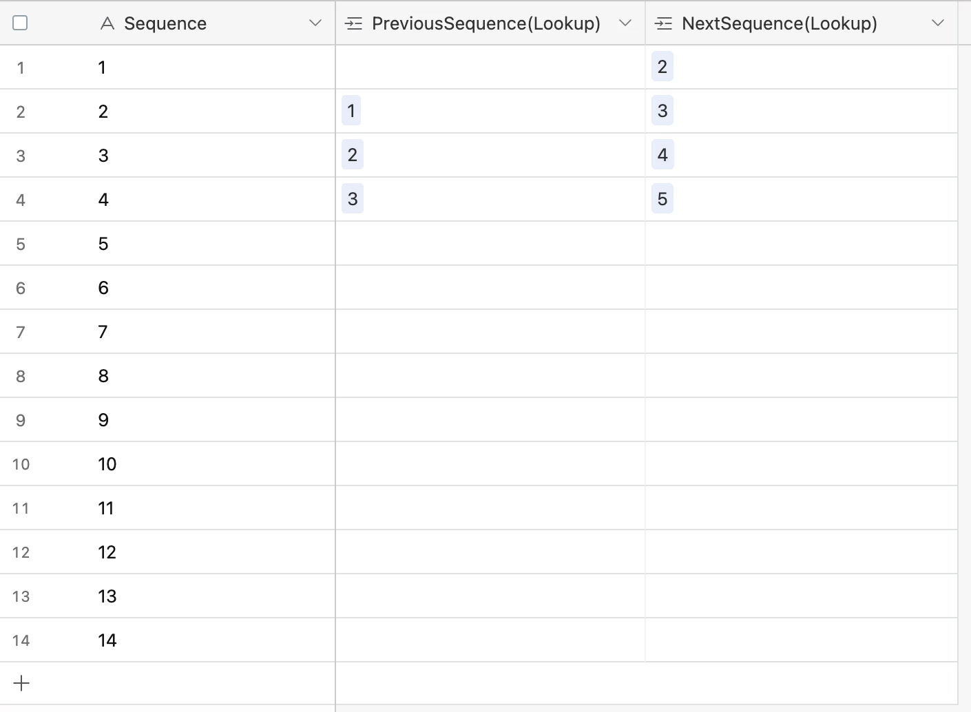

I've got a number of records, called "Sequences." I need to define the relationship between them, and track which one comes next and which one comes before. In the image above, those relationship are defined manually.

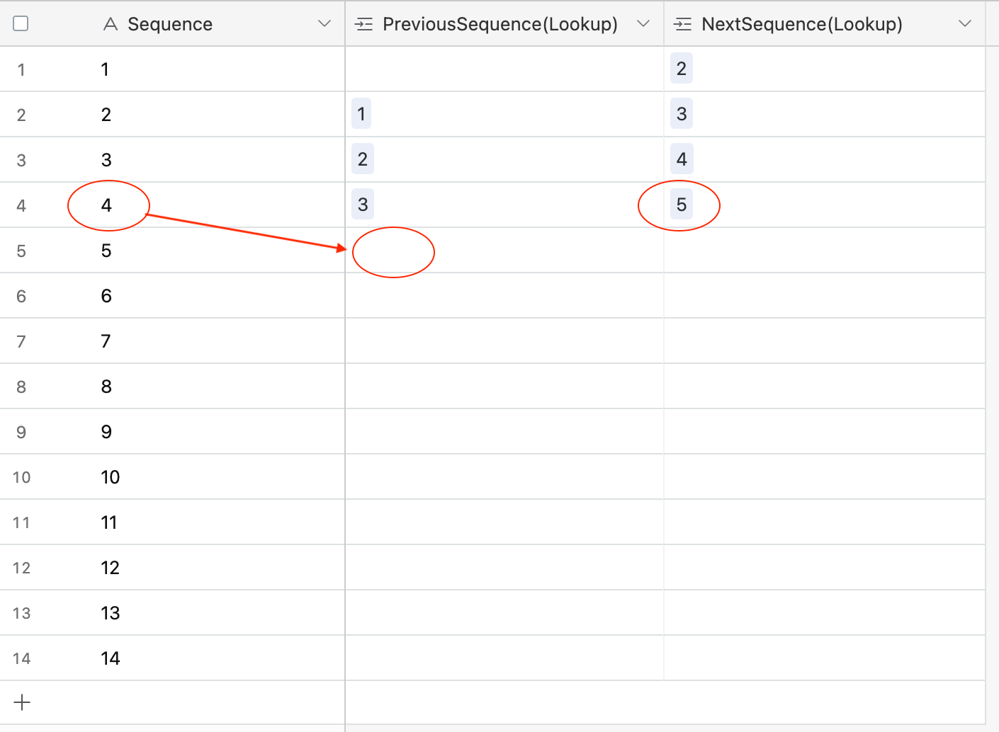

In the below image, I've replaced the manual versions with Lookups:
What I'm seeking to do is this: when I specify the record for the Next Sequence, have that Sequence's record automatically update it's Previous Sequence field with the corresponding record. For example in the below image, in record Sequence 4, when setting Next Sequence to 5 - I'd like for the record Sequence 5 to automatically update the Previous Sequence field with the record Sequence 4.
Is this even remotely possible using some configuration of Lookup Fields? Or automation? I'm at a loss.

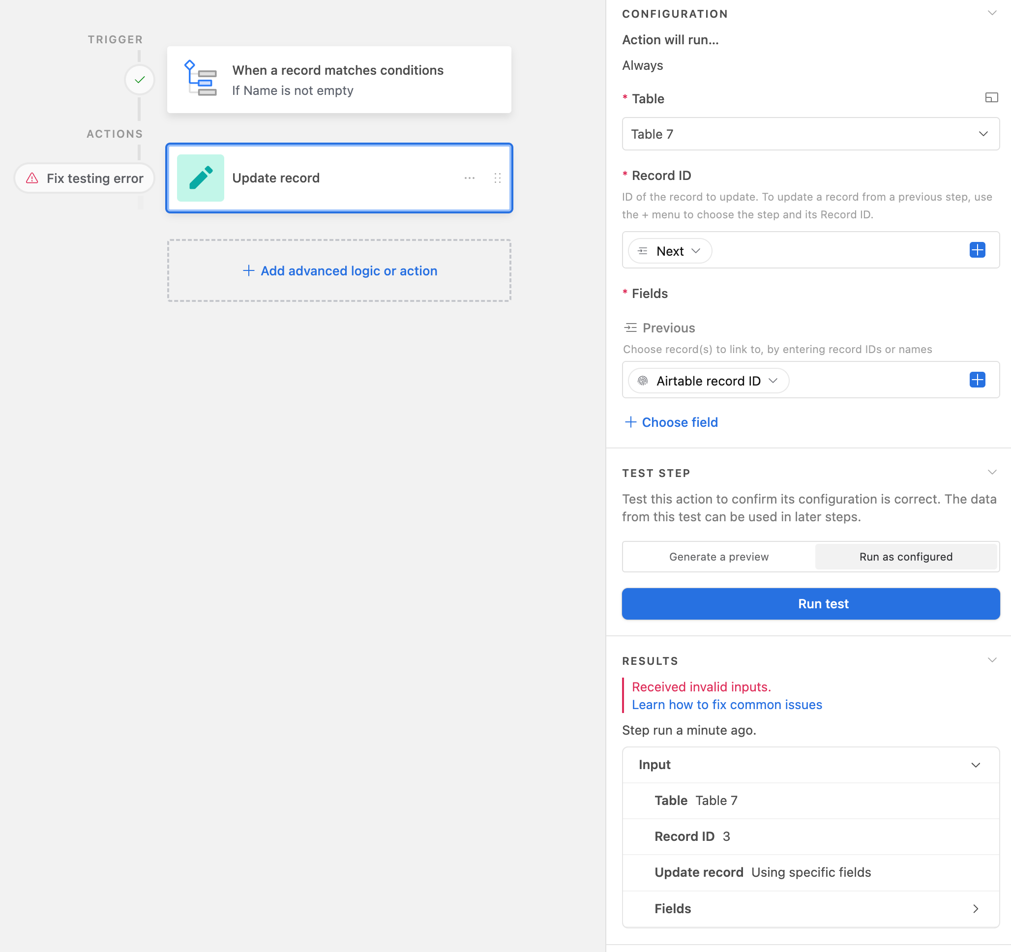

Thanks!  I tried to replicate the Automation you built, but it's giving the error: "Received invalid inputs." I think I've copied everything in the automation and config correctly.
Any idea what I'm missing?  

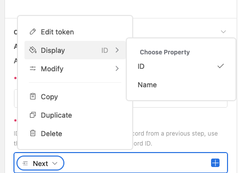

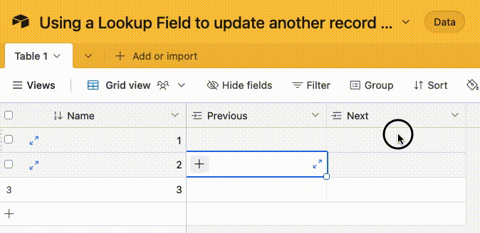

Hm, could you try: in "Record ID", click on "Next", then "Display as" and select ID?
  • March 23, 2023

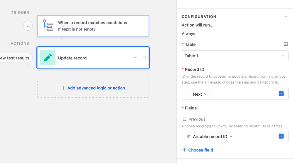

That seems to work! Gonna do some more testing to confirm. Thanks!
  • March 23, 2023

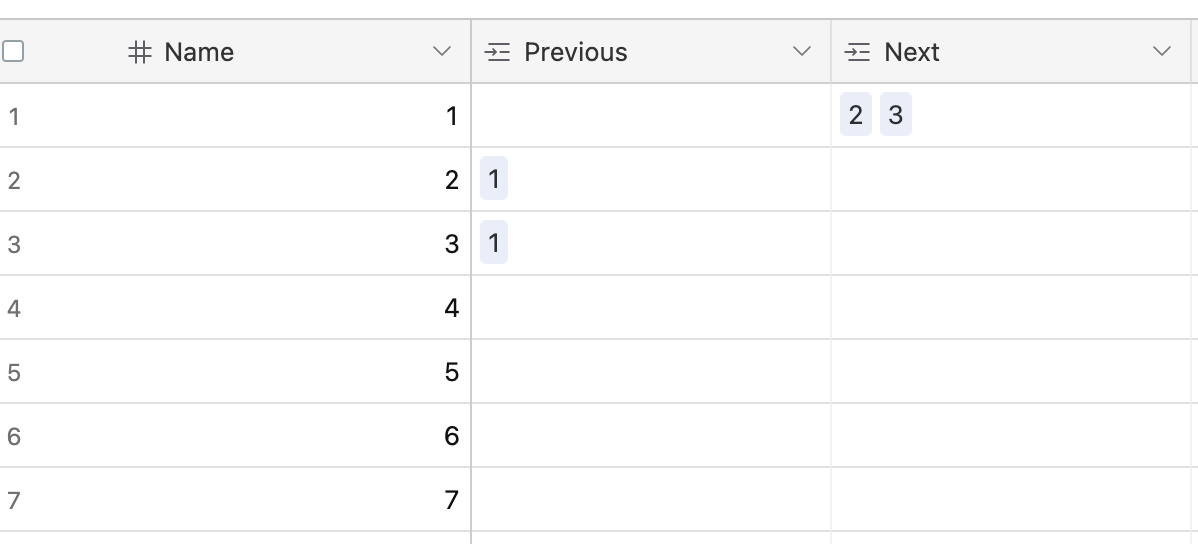

This gets me most of the way there. One setback - I have some cases where I need to have multiple records in the Next field. For example, if Record 1 needs to connect Next to both Records 2 and 3. But it looks like the automation can't handle multiple inputs?
Ah try using repeating groups for that, using the records in the "Next" field as the list
  • March 24, 2023
Thanks! I set up repeating groups and got it to work with multiple records in the Next field
But when I set two different records to link back to the same one....rather than having both records show up in the Previous field, the second one added overwrites the first one. Any thoughts?

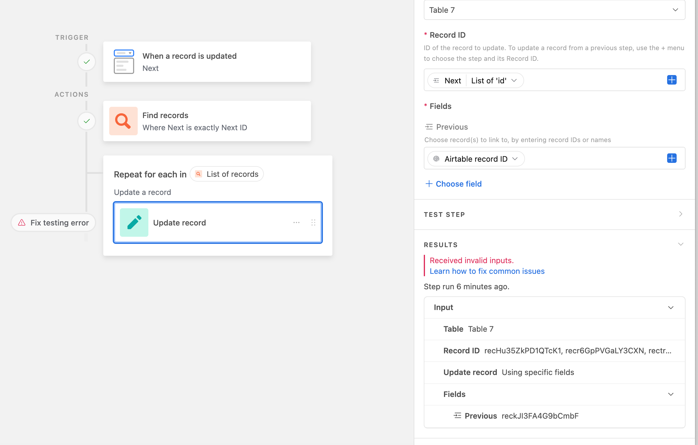

Thanks. I updated it with the Find Record action, but it keeps failing at the final step:
In that last step, I feel like the problem is with the field specified for "Record ID." In the screenshot, it's set for "Next | List of 'id'", and it doesn't work. But I can't figure out which way to configure that step.
