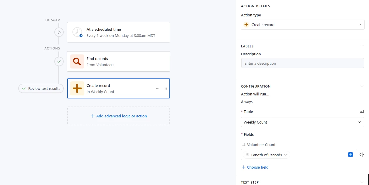

  • Aug 21, 2025 11:31 PM UTC
Here’s a breakdown of how to do this within Airtable.
Create two tables, one with Volunteers, one for your Weekly Count. Create your automation:
  1. Automation Trigger: At a scheduled time → Weekly: day and time
  2. Find Records: Volunteers Table → Whatever view or condition has the volunteers you’re looking to count and record (all records, new in the last week, first name Susan, etc.)
  3. Create Record: In Weekly Count
    1. Table: Weekly Count
    2. Fields: Volunteer Count
      1. Dynamic
      2. Find Records → Choose Records → List Properties: Length
“Length” counts the line items in a view, and this automation will create a new record with that number.
​@VoodooGuru ​@ScottWorld Google AI is saying this is impossible based on this thread.
