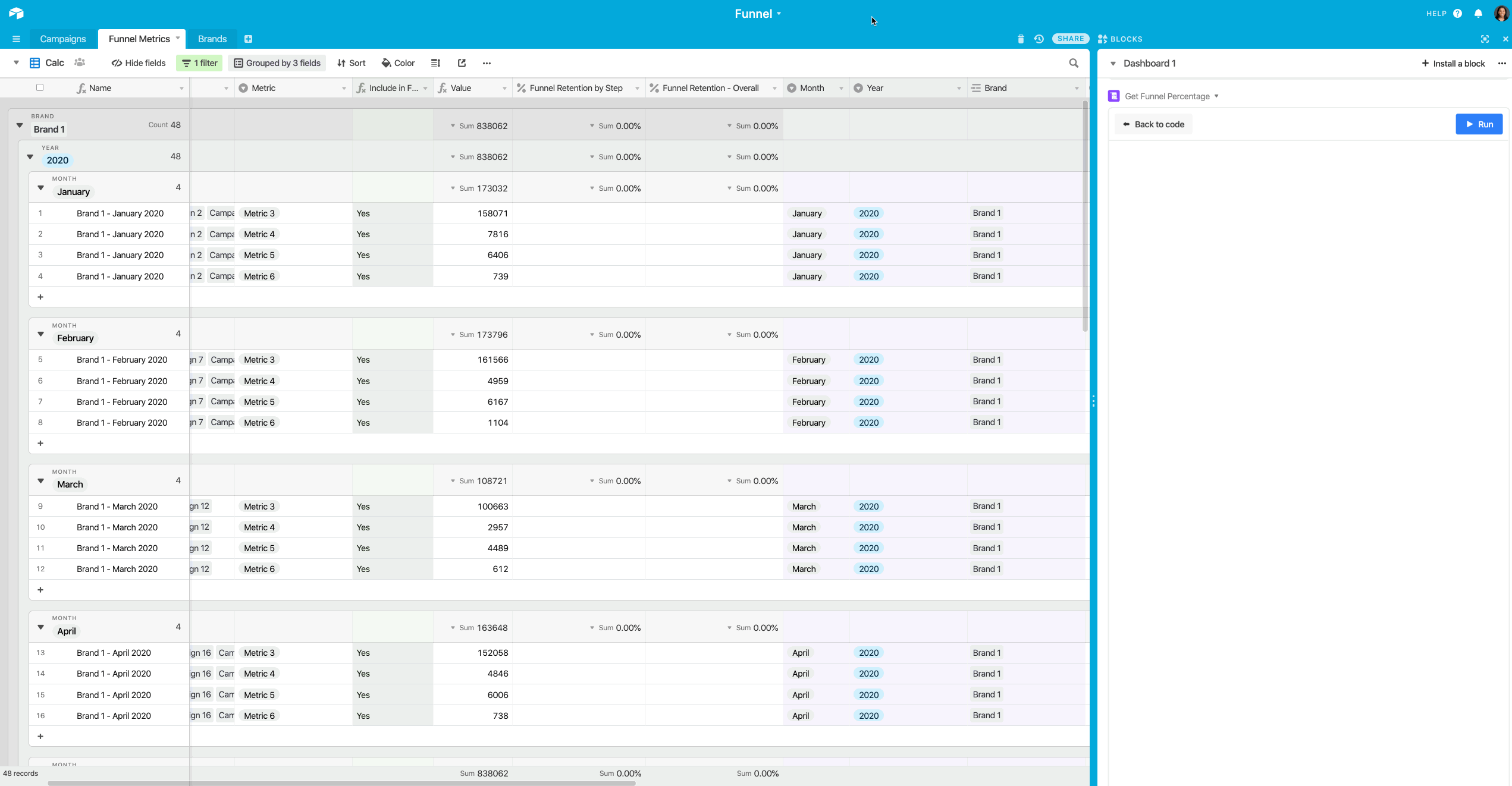

So I’m working on a use case where I need to determine metrics for a funnel. I want to know two things:
  1. the percent of value that remains in the funnel from the previous step, and
  2. the percent remaining from the beginning of the funnel.
So that looks like:
Metric A - 10,000 | 100% | 100%
Metric B - 5,000 | 50% | 50%
Metric C - 1,000 | 20% | 10%
Metric D - 500 | 50% | 5%
This of course would require me to use the previous value in a function, something that Airtable isn’t built for on its own, but it is something that people have found great workarounds for, like @W_Vann_Hall who has covered a great workaround thoroughly in this post. I happen to be dividing, but this is also great if you’re looking to do a running balance as well.
To make this easier and cleaner, and just to see if I could do it (tbh), I tried my hand at a script that will do this in a snap.
The Pros: No complicated rollups
The Cons: Since it uses the scripting block, it doesn’t update automatically.
Here’s a a video of me walking through the base setup and the script, and here’s the example base, which has a couple of other scripts in it was well for you to play around with. I’d love to know how you’d improve this or use this, and happy Airtabling and Scripting!

let funnelTable = base.getTable('Funnel Metrics');
let funnelQuery = await funnelTable.selectRecordsAsync();
let funnelRecords = funnelQuery.records;
let months = funnelTable.getField('Month').options.choices;
let years = funnelTable.getField('Year').options.choices;
let metrics = funnelTable.getField('Metric').options.choices;
// Goal: use the preceding number in the funnel to calcualte the percentage
// For each group - create an array of the funnel numbers
// Create an array of the values you need, as well as the ID of the record so that you can update it later.
// I've also added a filter to this array, because there are some records in this table that I don't want to include in this calculation
let recordsMap = funnelRecords.map(c => ({
    'include': c.getCellValue('Include in Funnel Calculation'),
    'value': c.getCellValue('Value'),
    'id': c.id
})).filter( x => x.include == 'Yes' );
// This is where you'll definitely need to customize for yourself.
// Each of my campaigns has 4 steps, so I can decided to splice my recordsMap array every 4 values.
// Depending on how your information is structured you'll need to figure out the best way to separate your records into the groups you want to divide/add/subtract/mulitply by
let splicedArray = []
while (recordsMap.length > 0) splicedArray.push(recordsMap.splice(0, 4));
// Using forEach and reduce, I'm able to go through each of the splicedArrays in splicedArray
// and use the reduce function to caluclate the percentage and add two new key value pairs to the objects in each splicedArray
splicedArray.forEach(function(array){
    array.reduce(function(acc, curr, i, array){
        curr.funnelVal = curr.value / array[i - 1].value;
        curr.totalFunnelVal = curr.value / array[0].value
// Getting this in the right format for batchAnd as well as updateRecordsAsync
let update = splicedArray.flat().filter(x => x.funnelVal != undefined).map( c => ({id: c.id, fields:{
    'Funnel Retention by Step': c.funnelVal,
    'Funnel Retention - Overall': c.totalFunnelVal

@VictoriaPlummer I think your solution here is on track for what I’m trying to do but I’m having trouble making the leap.
I have external users inputting new financial information regularly. Each time, they create a ratio, that, when divided, becomes something we call their "share price. So if the ratio is $100/$2, then it’s a $50 share price (100/2). What I’m trying to do is create a few different ways to compare those entries and the “share price” it creates.
For example, if you inputted your information on 12/31/2017 and the share price was $50
Then you inputted your info on 12/31/2018 and the share price was $75
I want to calculate that the change was +50% ($75 is 50% bigger than $50).
When you input your info on 12/31/2019 and the share price was $100.
Now I want to show that your 1-year change from 2018 to 2019 is 50% and your 2-year change was 100%
And to be able to calculate that for each entry that gets put in.
Your funnel calculator is close but I don’t understand it enough to figure it out for my needs.
Help!
