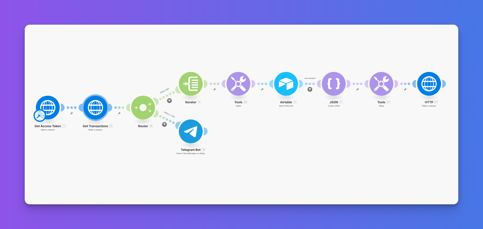

Hey, thanks for the answer and sorry for the lack of context - it passed tests and ran fine for a few days / up to a week, then I checked the database and I noticed that transactions were getting duplicated.
Here's the screenshot of my scenario - it's super simple, it fetches transactions from the past 7 days, iterates over them, then the Airtable module checks if fetched transactions exist in the database by ID and, if not, sends them to the 2nd scenario that adds them to the database. I work with Make a lot, so there's nothing that that could be the reason for this error except the AT module.
As per your recommendation, I changed the "Find" formula into "{transactionId} = <transactionId>" and so far it works well, thanks!

Hey, thanks for the answer, I work with Make and Airtable a lot both professionally and personally, so I already learnt to avoid this kind of mistakes.
In this case, it seems to me the problem was caused by the formula - when I switched to "{transactionId} = <transactionId>" from "FIND("<transactionId>", {transactionId})=1" - as suggested by @TheTimeSavingCo  - I stopped getting duplicates.
It's strange the FIND formula caused this type of error, as the formula output in a 'test' Airtable column was correct 🤔 🤔
