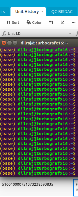

I haven’t changed my API in a long time, but for some reason when I do the following get:
returned_dictionary = at.get(unit_history, view='Default', filter_by_formula = search_term)
Where search_term is equal to: '{Unit I.D.} = "510040000751373238393835"'
And here is the data in the TABLE and the CORRECT COLUMN. (Click the image to see the record.)
but returned_dictionary just returns OrderedDict([('records', [])])
I would guess that the view, “Default” has changed or been removed. Try changing this:
to this
returned_dictionary = at.get(unit_history, view='', filter_by_formula = search_term)
