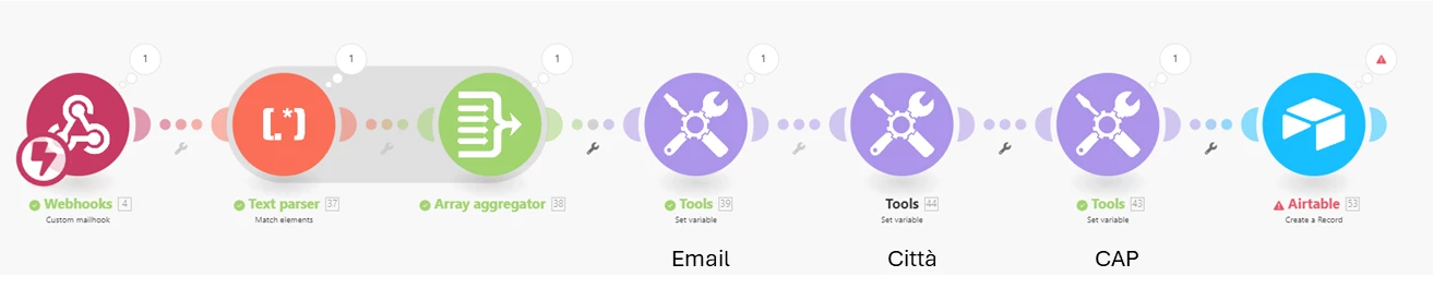

I'm developing an automation with Make that should extract specific values (Email, Città and CAP) from an email body.
The values should be saved into airtable fields.

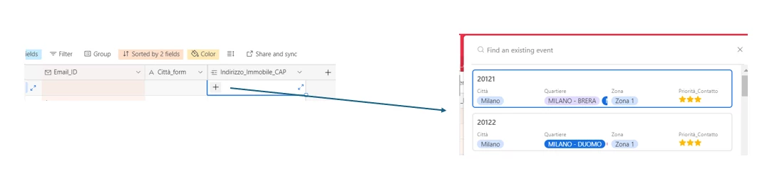

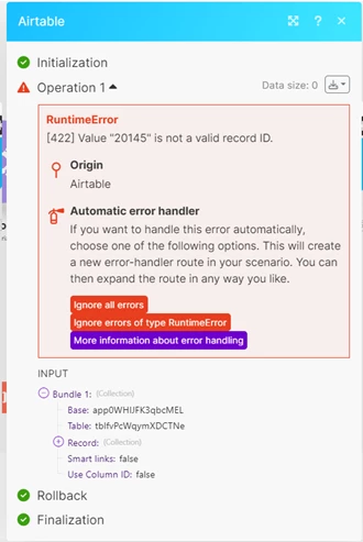

Make returns the following error message when tries to save the extracted CAP value into the airtable field "Indirizzo_Immobile_CAP".
The field "Indirizzo_Immobile_CAP" is linked to another table.
I've contacted Make support and they told me what follow:
"Upon inspecting the log, it looks like the field called "Indirizzo_Immobile_CAP" is the one causing this issue showing the record ID is incorrect. Unfortunately, I'm not sure why Airtable's API is rejecting the value for this field."

If you want to add records to a linked record field, Airtable’s API requires you (by default) to add them by their record ID, not by their primary field name.
Airtable’s API also requires you (by default) to choose from an existing linked record that already exists.
If you want to add linked records by their primary field name or if you want to create new linked records, then you need to turn on Airtable’s “typecast” function when making your API call.
In Make’s Airtable automations, they refer to Airtable’s typecast function as “Smart Links”, so you need to turn on the “Smart Links” option at the bottom of the “Create A Record” module.

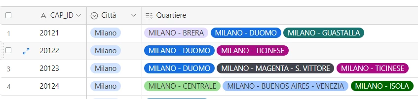

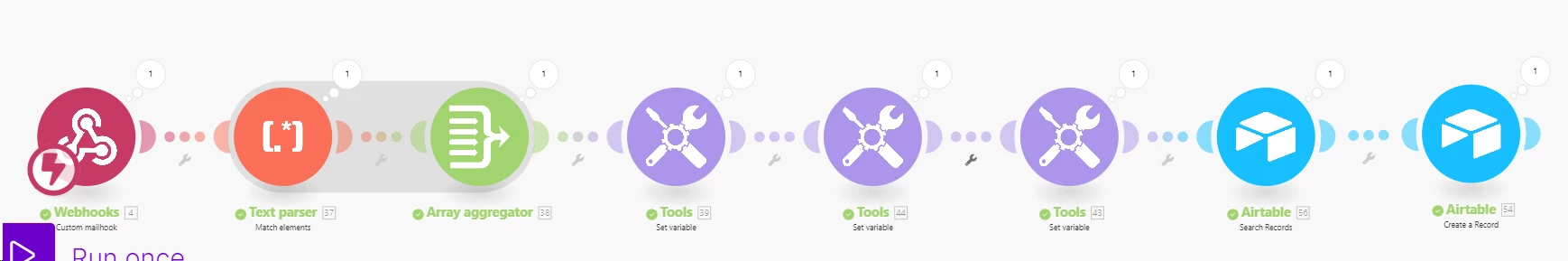

I've added a search record module to get all the records ID available in the linked table (i.e. "Zone_Immobili").
here below table "Zone_Immobili"
The search records module has been set as shown below:
If I set the bundle limit to 40, the search module returns all the 39 records.
Since I want to recall just one record, I've entered 1 in the limit field.
Now I'm tring to set the filter with the aim to find the record ID associated to this condition:
CAP_ID = CAP (i.e. value returned by the Set Variable Tools)
In other words, if the email body contains CAP: 20123, I expect that the returned CAP variable will be 20123. Then I want to filter the records to find the one associated to CAP_ID = 20123
