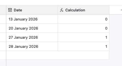

Hm as a datapoint I just tried this via Postman with both a GET and a POST and it works fine.  Could you provide some screenshots of your data and the full body of your POST?
GET with URL params
https://api.airtable.com/v0/appz6YcyO3dXfqDWV/tblVg5MfRaHq9Cnvt?filterByFormula=IS_AFTER({Date}, '2026-01-25T00:00:00.000Z')
POST with JSON
URL
https://api.airtable.com/v0/appz6YcyO3dXfqDWV/tblVg5MfRaHq9Cnvt/listRecords
Body:
"filterByFormula": "IS_AFTER({Date},'2026-01-25T00:00:00.000Z')"
Return:
"records": [
"id": "recelxVi6HgvyfFeT",
"createdTime": "2026-01-27T14:37:26.000Z",
"fields": {
"Date": "2026-01-28",
"Calculation": 1
"id": "recmCfH2Xhij23hTl",
"createdTime": "2026-01-27T14:36:29.000Z",
"fields": {
"Date": "2026-01-27",
"Calculation": 1
Here’s my data:
