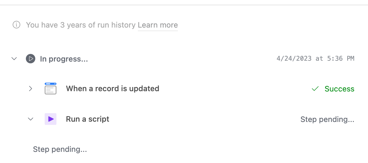

I've seen issues opened about this two months ago but we're experiencing this issue now.
I tried leaving the script for an hour and the state doesn't change, though if I run a test of the automation, everything works.
The status page shows there are no incidents.

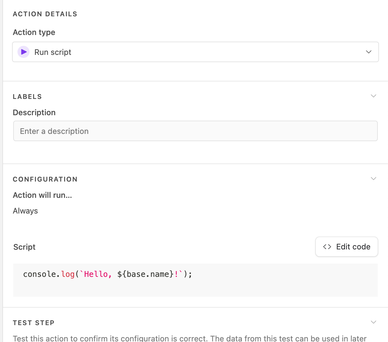

I've also tried creating a new automation that only runs the following script and it still gets stuck -
