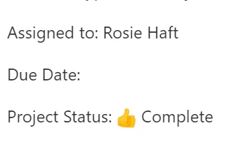

At present, I have created a task management system and am trying to create a better notification system.

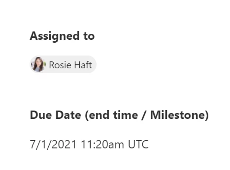

I would like to be able to format sections of the notifications and in addition have similar formatting to how Airtable provides notifications natively:
This is what it looks like without formatting:
