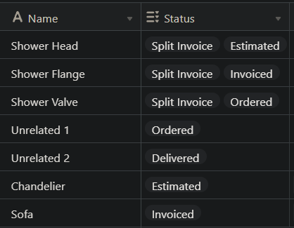

Right now I have a multiple select field as follows:
The script I’m trying to run has already identified the record IDs of all records with “Split Invoice” as a status.
What I’m trying to do now is to remove that split invoice status and leave the rest (For example Estimated, Invoiced, those can all stay).
What’s the best way to do this? All I can think of is to create an array of all statuses except for “Split Invoice” but I’m not sure how to write the syntax for that either. Code below:
