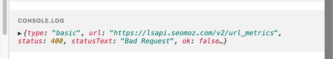

I signed up for your API yesterday to access from my AirTable - and I’m writing some scripting language stuff and having difficulty accessing it. I’m not sure if the issue is my authorisation or something else.
Any input you could give would be much appreciated.

Here is the response:
If you have any input on how I could do a basic request for some data just as a proof of concept to actually have JSON returned on any of the functions (as they all have the same result for me) - it would be much appreciated.

Not sure if you solved this already, but you need to stringify the request body:
let response = await remoteFetchAsync(‘https://lsapi.seomoz.com/v2/url_metrics’, { method: ‘POST’, headers: { ‘Content-Type’: ‘application/json’, ‘Authorization’: ‘Basic ${encoded key and secret}’ }, body:JSON.stringify({“targets”: [“moz.com”]} });
Also, very bad idea to post your credentials. I hope you deleted them and that no one abused them on your behalf
