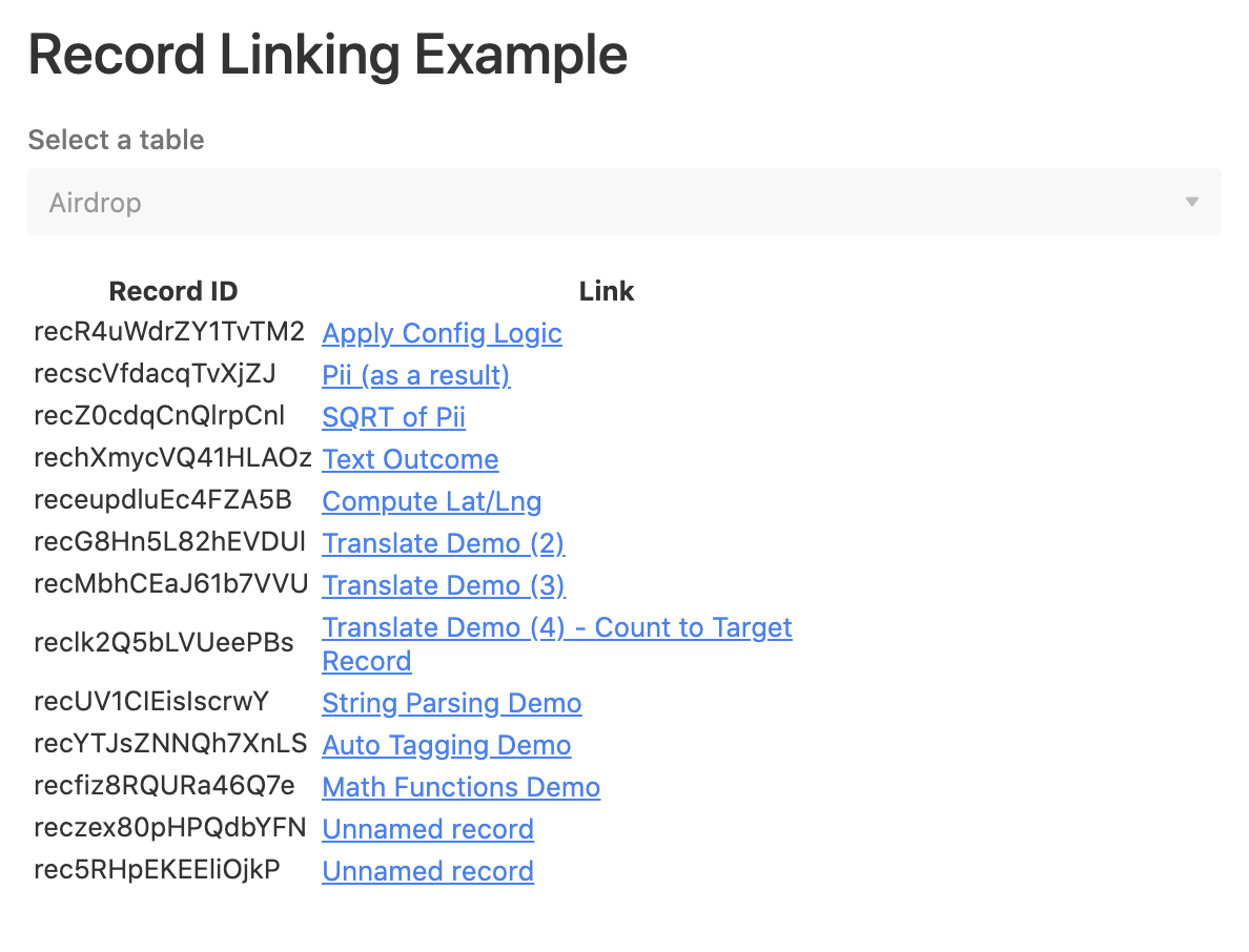

Thanks Bill for the answer. I already use output.table and output.markdown() but don’t find any way to have a link to an expand view of the record with that ? you know what i mean ? :slightly_smiling_face:

I believe I do and it works great for me -

Oh ok, i understand the difference. Sorry for not being clear.
What i want is the Record Id here to be expandable. You’re right that a “link to another record” field works, but i don’t see how i can have the whole records itself expandable.
In your example, i want to be able to click on the record id for example.
Thanks again for your time

Okay, and then what happens exactly?

It open the same popup when you expand a record on a view list or when you click on a “linked field” records

Like this?
In case this is what you were hoping for - here’s the script block:
output.markdown('# Record Linking Example');

A little bit different than what i expected (because it open a new browser tab instead of staying in the same tab and instance of airtable), but it will do the job i think.
I was expecting a native way for airtable to have a link to the expand card, but forging the whole url seems to work.
