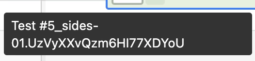

When I’m using this right now, it’s for some reason adding the name of the file at the end of it when the name changes…
I’ve spent nearly 1.5 hours trying to solve this in different ways, but can’t figure it out. Does anyone who is better with scripts know how to change this?
This is what it is currently giving me, and I don’t want the weird stuff at the end… I want it to end at .PDF, which it’s currently pulling from the name field.

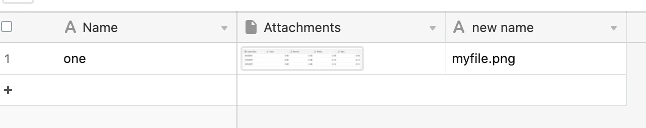

Hi @Cameron_Goldberg - I’m not exactly sure I’ve got your scenario correctly, but it sounds like you’ve got an attachment and another field with a filename in it, like this:
If there’s only one attachment in the Attachments field and a single filename to go with it, something like this will work:

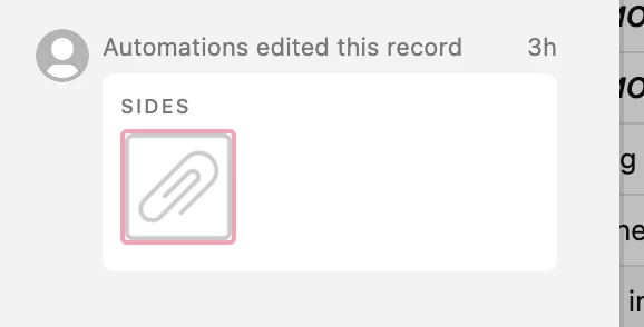

Secondly, it actually deleted 2 files (BIG PROBLEM) today when uploading after using the script 100 times without problems… So I’m a little stumped. Perhaps you know why?

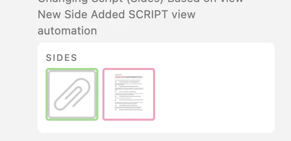

just a bit more context, this is what normally happens:
this is what happened and it’s super concerning:
and what is strange is the file is correct on the one that was removed… anyways, throwing a lot of extra info so you (or anyone) has context.
