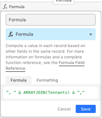

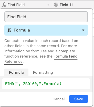

You cloud try adding your separator at the start and end of the field created with the ArrayJoin() and then searching for a string including the separator at the beginning and end of your desired string…
and
Not that pretty but I think it works.
and
Wow. Great idea! I think it’s working. I was thinking I would need a new formula field that would format these items as something like #ZR0100#, but making the API call with your formula would be nicer since I won’t have to pollute the database with unneeded info. Thanks @Julian_Kirkness!
