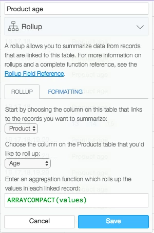

  • August 3, 2016
Some more information to see if it helps:
This is how the Product age field is created:
