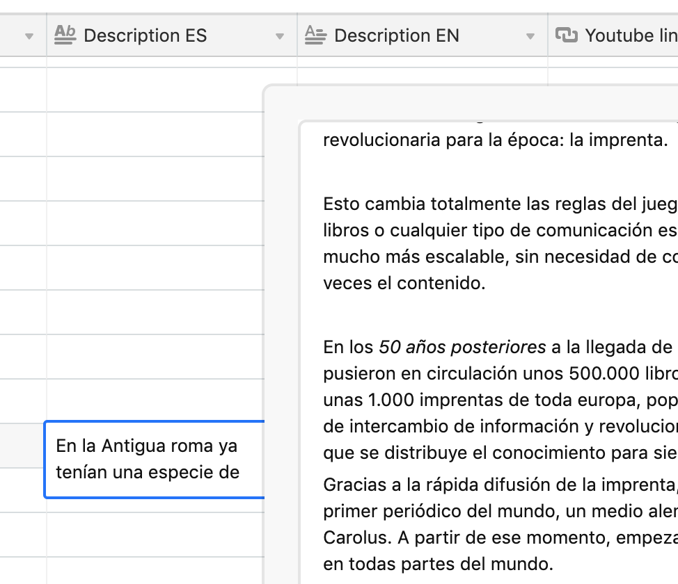

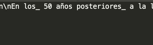

When I retrieve the content of a rich text enabled long text field through the API, only “bold” formatting works. Strikethrough and Italic are retrieved with a whitespace before the markdown symbol and therefore are not parsed correctly.
Example:
Is retrieved like this:
You can see how 50 años posteriores shows up as _ 50 años posteriores_ instead of underscore50 años posterioresunderscore without spaces between the underscores and the thing I want to make italic.
Has anyone experienced this? Is there a way to fix it?
Best answer by kuovonne
I suspect that you are seeing a space between the underscore and the other characters that are italic because when the text was originally placed in italics, the space was also included as part of the italicized text. You don’t see the space as italicized because a space in italics looks exactly like a normal space.
I have tried formatting rich text as italic, bold, strike-through, etc., (both including and excluding surrounding spaces), and the Markdown source returned by the Scripting API exactly matches what I entered. Even though you are using the Standard API instead of the Scripting API, both APIs should return the same values.

This makes total sense, I checked and that’s what I think is going on there, but is this how Airtable should interpret it?
_ITALIC _ and ITALIC
Both should never be italic, so I think Airtable’s interpreter should remove leading and trailing whitespaces before placing the formatting symbols… right?
