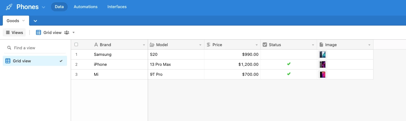

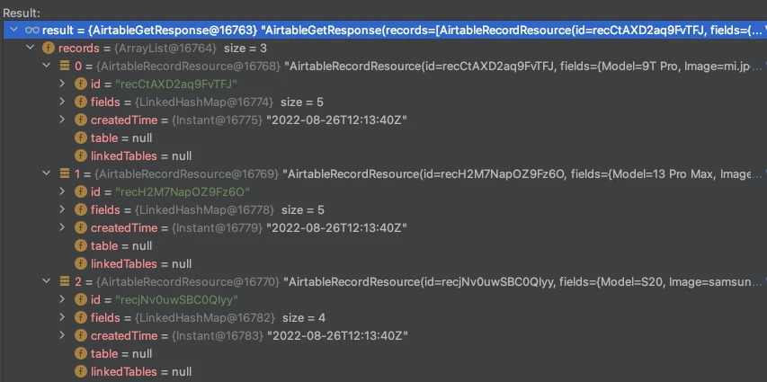

OK. this is my demo table, which has several records. I do not defined recordid field for my records, but as we know each record has record id like this "recctaxd2aq9fvtfj". So in my application I have conditional filters to fetch data from table by Brand, Name, Model etc.... I want to fetch data bu record id as well, but dont want to explicitly define record_id column in my table. I want to use the record id which comes with each record as you can see in code response screenshot.
So this query is working:
AND(OR(SEARCH(",MI 9T pro", "," & SUBSTITUTE(LOWER(ARRAYJOIN({Model}) & ","), ", ", ","))))
But this is not working:
AND(OR(SEARCH(",recctaxd2aq9fvtfj,", "," & SUBSTITUTE(LOWER(ARRAYJOIN({record_id}) & ","), ", ", ","))))
