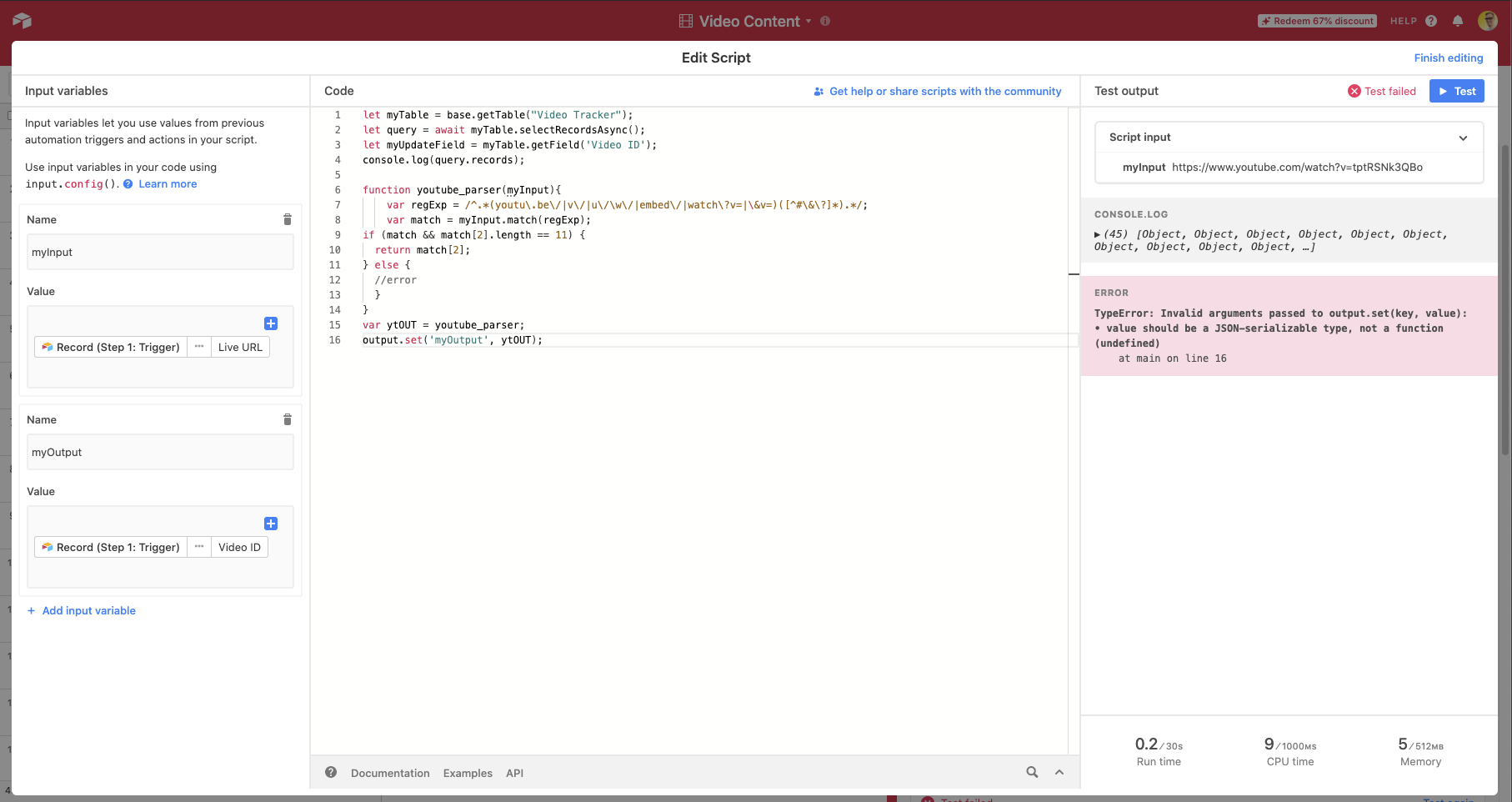

And the error I get that I cannot make heads or tails of:
ERROR
TypeError: Invalid arguments passed to output.set(key, value): • value should be a JSON-serializable type, not a function (undefined)
at main on line 16

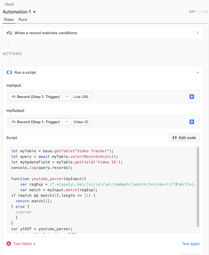

Here’s my Edit Script screen overall
and the Automation overall if it helps:
Thanks for any help.
Bill_French
I think this is where the issue is - I think it needs to be:
var ytOUT = youtube_parser(myUpdateField);
Bill_French
Maybe I’m missing something, but I get the sense that you’re missing something that definitively sets the value of the URL that needs to be parsed. I see you open the table and get the records, but where do you decide which record to use in the parse process? I assume you want to run this process for all records, perhaps?
Another thing - to get the value of the youtube ID from the URL, you don’t need the youtube_parser() function; rather, I think this is all you need given the URL is in a variable…
  let myInput = "https://www.youtube.com/watch?v=YAIlMUX9VLg";
  let ytOUT = myInput.split("?v=")[1];
  output.set('myOutput', ytOUT);

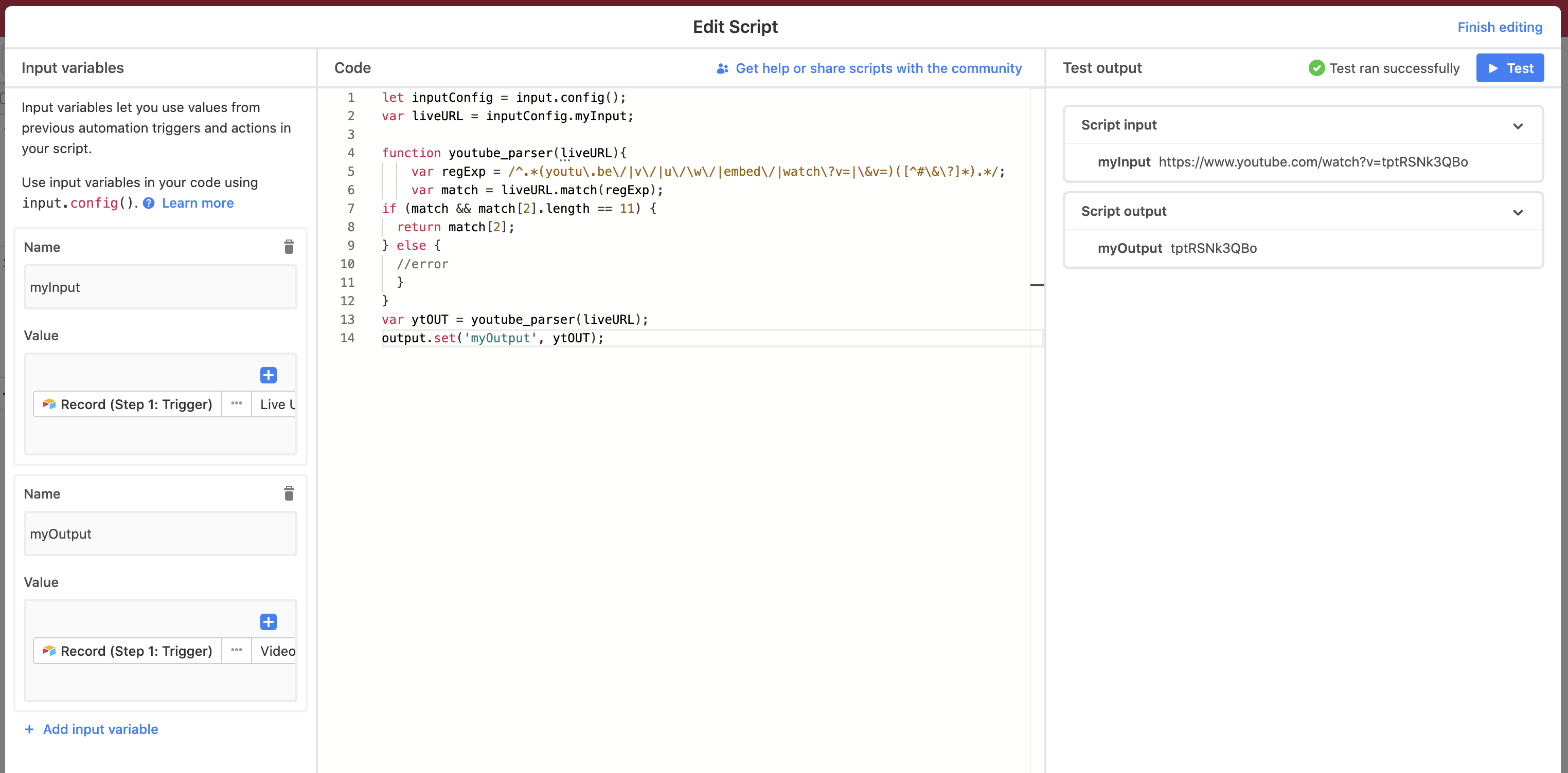

After a bit more guessing and testing, I found this article that helped me revise the input variables I had entered on the left (wasn’t calling those and didn’t know how till I saw the example).
Thanks for pointing me in the right direction. After turning this automation on I’ve realized that it’s not going to process all my existing entries but only new ones :thinking: . Not the end of the world I suppose.
Here’s my working script (for new entries)
let inputConfig = input.config();
var liveURL = inputConfig.myInput;
function youtube_parser(liveURL){
    var regExp = /^.*(youtu\.be\/|v\/|u\/\w\/|embed\/|watch\?v=|\&v=)([^#\&\?]*).*/;
    var match = liveURL.match(regExp);
if (match && match[2].length == 11) {
  return match[2];
} else {
  //error
var ytOUT = youtube_parser(liveURL);
