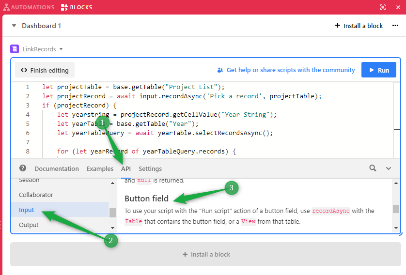

Use a Button field and configure it to call your script.
This code will not prompt the user if the Button field is correctly configured:
let projectTable = base.getTable("Project List");
let projectRecord = await input.recordAsync('Pick a record', projectTable);
if (projectRecord) {
    /// do something here
Here’s where to find the documentation:
When an automation is triggered by a record, the record’s ID and field details are passed to the automation automatically. In the script action step, you can add one or more variables to pass to the script based on almost anything collected from the triggering record.

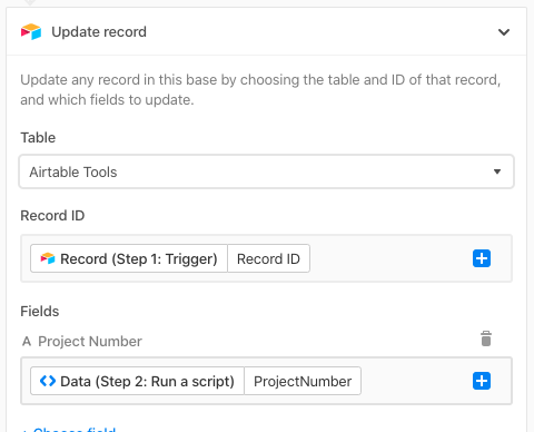

I just replied in another thread you’d started with info on how to get the record ID into your script. Getting the new project number back out is similar. Let’s say you’ve done some calculations and assigned the project number to a projecNumber variable. At the bottom of your script, add this line:
output.set("ProjectNumber", projectNumber)
After the script action step, add an “Update a record” action, and set it up kinda-sorta like this:
